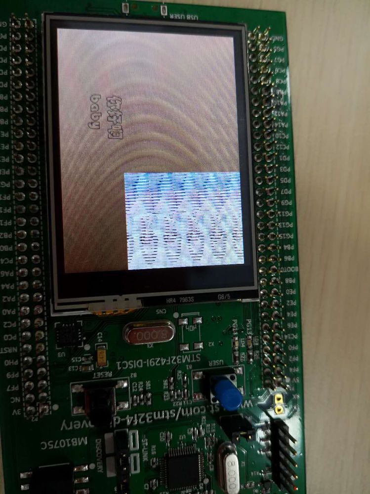

I'm trying to create an application oriented natively to landscape. But I don't know how to generate my images in that format ,because I can't open the website you offered before .Can you give me a new website ? And my device is F429 Discovery . I only need landscape mode .0693W000001szL7QAI.jpg
Hi, the new documentation site is https://support.touchgfx.com
In regards to your issue: Go to the "Config" tab in the designer and you can specify "display orientation" of the application itself and also rotation for images.
