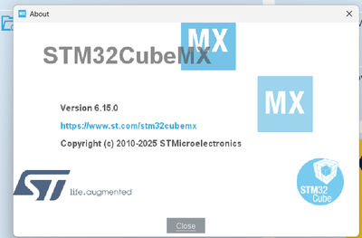

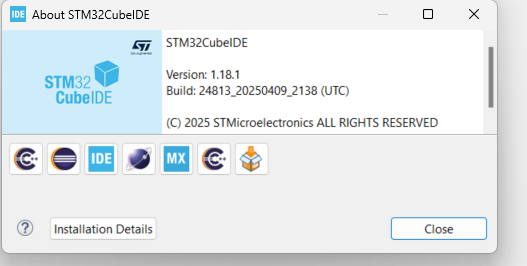

Here are my application versions.
  1. CubeMx Version
  1. CubeIDE Version

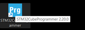

STM32CubeProgrammer

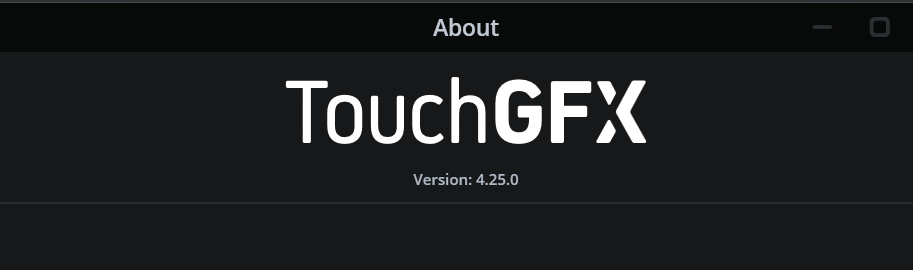

TouchGFX (last one)

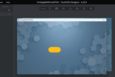

In TouchGFX Designer, I can simulate my application

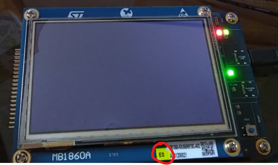

After discussion with a ST Field Engineer, it appears that the trouble is coming from that the board STM32U5G9J-DK2, I have is an ES version.
On this kind of board, the blank screen was reproduced by the ST Field Engineer. I am waiting an official board of the STM32U5G9J-DK2 (not ES version). I'll tell you if it works better and if the problem is fixed

This is confirmed, this is a trouble with the STM32U5G9J-DK2, ES Version.
With the official release version of the STM32U5G9J-DK2, we don't have anymore problem to upload any application.
I did not have the good board version.

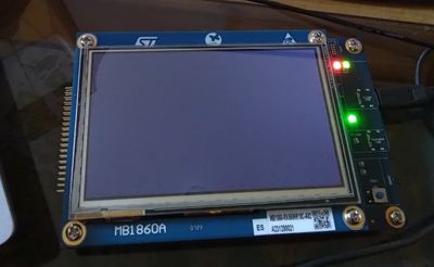

I am facing the same issue on 2 out 10 STM32U5G9J-DK2 Boards I have bought 5 months ago. How can I check out the board version (ES Version or official version)? Is there any indication referring to the board version?
Osman SOYKURT
Normally our ES have this label printed and sticked on the board itself, like on the shared picture. Have you bought your boards (including the ES boards) from our store or from another supplier?
