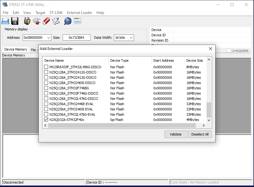

Hello to everyone. I am working with STM32F429 mcu on Touchgfx. I have successfully run the Touchgfx. I am using a 7inch screen and sending images line by line with DMA. I want to use an external flash as I have too many images to use. I am using W25Q128 flash. Normally I was able to write and read, but could not integrate it with Touchgfx. I could not integrate the MB1642BDataReader library in the STM32G0 example into STM32F429. Would you help me with this topic? Am I following the wrong path? @Flemming Gram CHRISTENSEN​ @Martin KJELDSEN​

I don't know how to make an external flash loader. But I found one spi flash loader in ST utility external loaders. There should have a way to make one.
Maybe post a new question to ask about this.
Hope you solve this problem.

It is basically a byte field in the loader header that specifies it being an SPI_FLASH
I'd need to know the pins and SPIx involved to port the W25Q128 loader over to an F4
