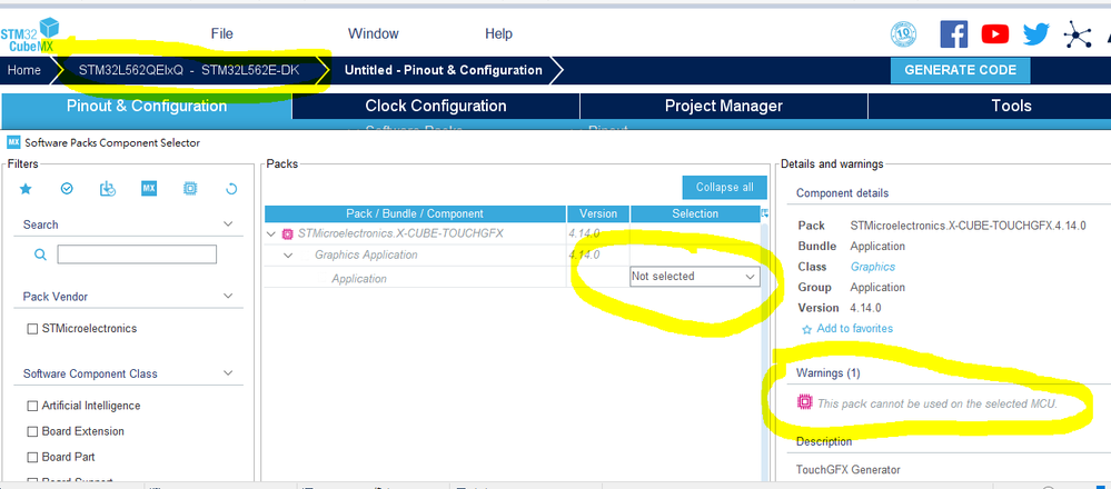

4.14.0 Could not select for Cortex-M33 (STM32L562E-DK) ?
CChan.4
4.14.0 new feature support Cortex-M33.

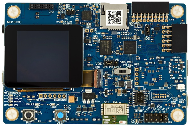

But why can't select for STM32L562E-DK ?
thanks
Alexandre RENOUX
Principal
Indeed we provide a Cortex-M33 library.
BUT the Generator does not update your projects yet so you cannot do what you are trying to for now. However this will be implemented for the next version 4.15 normally released in a few weeks.
/Alexandre
