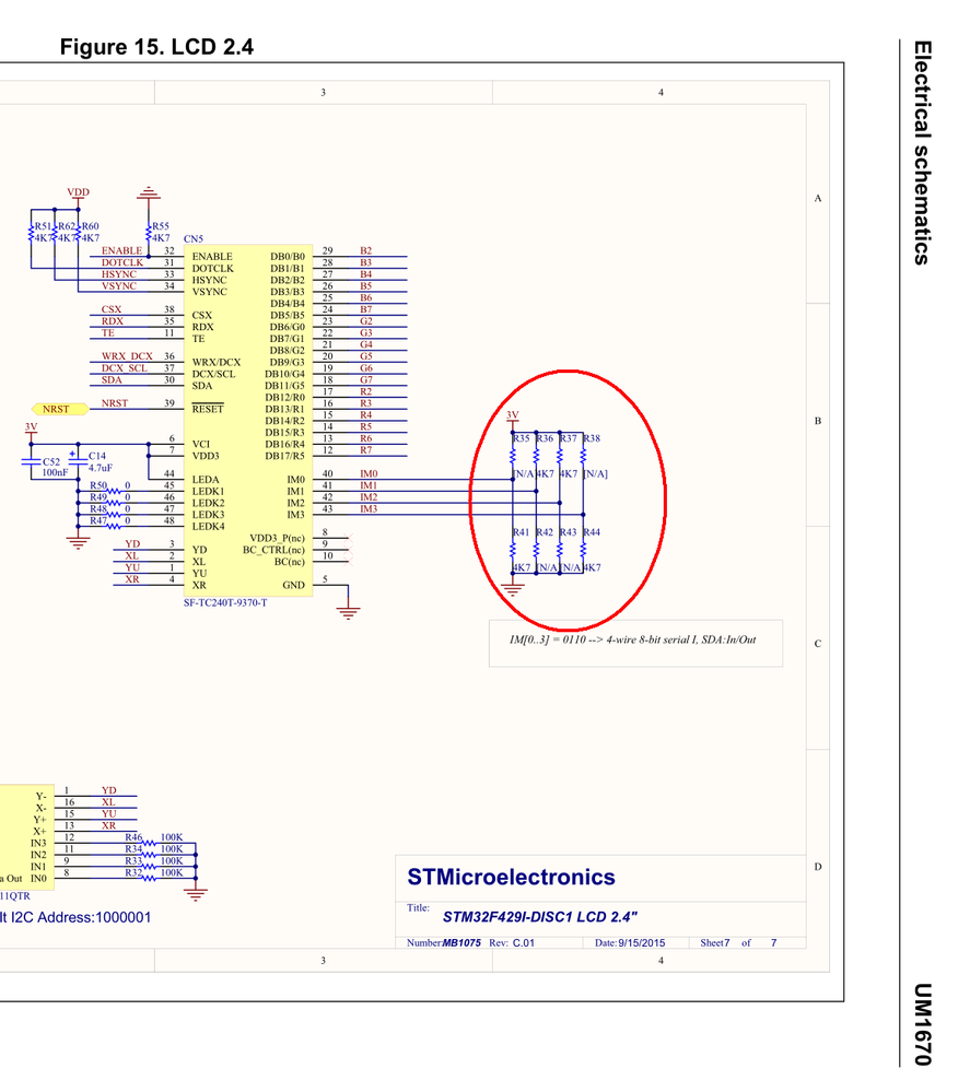

On 32F429IDISCOVERY, a set of resistors selects the onboard LCD mode:

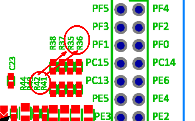

As can be seen, R35+R41 determine one signal's state, R36+R42 the second signal's state (and the other resistors the rest of the signals).

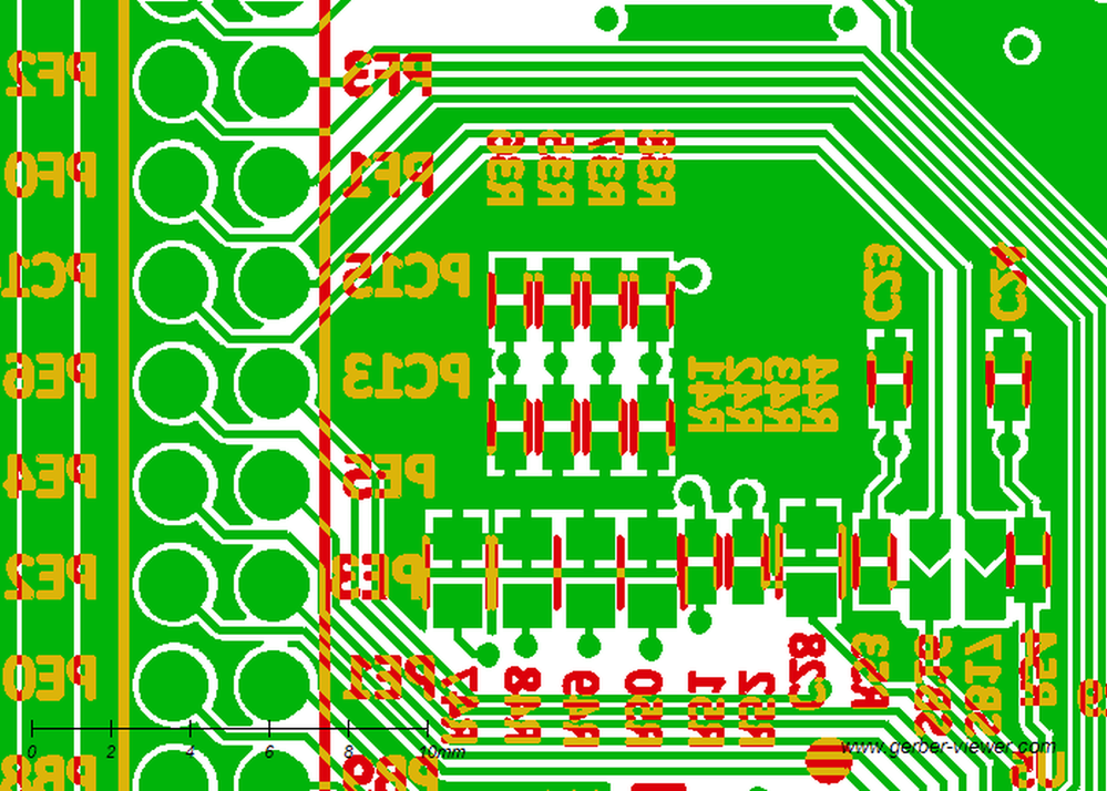

However, on silkscreen of the actual board, R35 and R36 appears to be swapped, as R35 is marked to be not next to R41 but next to R42, and vice versa fr R36:
also confirmed by looking at the gerbers:
