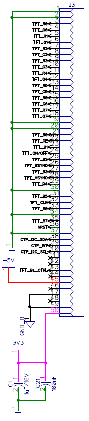

I am using STM32H7B33IIT6 MCU and 800x480 TFT. I can upload images to TFT, but I couldn't get the touch parts to work. But the same program works in STM32H7B3I-DK. What steps do I need to do?

Touchscreen is independent hardware. Usually it is an specialized external ADC on SPI or I2C bus. Check original schematics and your custom PCB. For example https://www.st.com/resource/en/schematic_pack/mb1332-h7b3i-b02_schematic.pdf shows that screen uses bus ​I2C4. Your should use the same bus and the same touchscreen IC - only then your firmware would work on both boards.

Thank you for answer but I use YB-TG800480S28A-C-A Yeebo screen externally, I made the pin connections accordingly. I connected I2C to I2C4 as in STM32H7B3I-DK. The screen is working. But the touch part is not working.
Do I need to write a special function for I2C? Can't I use I2C for STM32H7B3I-DK?

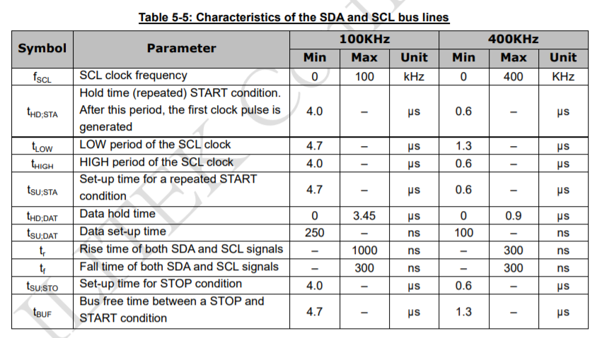

Thank you for comment but Both use the I2C protocol. I checked their datasheet. Are you talking about I2C Timing Characteristics?

No, I am talking about internal register structure and reading/writing sequence of those registers. You have to read datasheet for ​ILI2117A and implement algorithm described there. Timing usually is the same for many I2C devices. All should work at 100kHz, some can support 400kHz.
