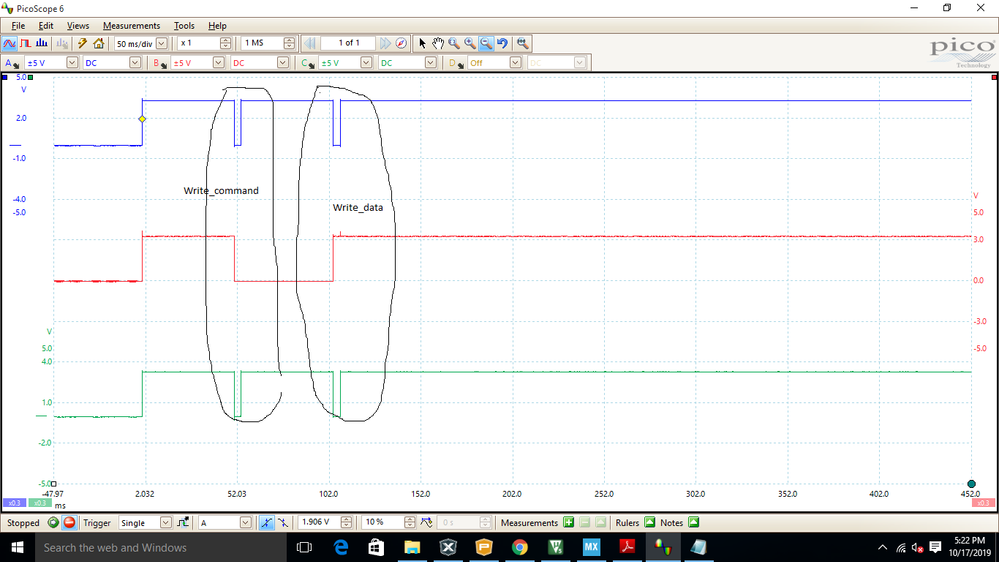

hi ,
i tried to interface TFT display 800X480 with stm32f401re. TFT display interface with SSD1963.
now the thing is that display does not showing anything .
i dont know the problem with initialization process or else.
the pin mainly used RS#, CS#.WR#, RST, RD# and 0-15 data pin . please go through the below pragamm suggest me where i am wrong . for initialization process of PIN i used STMcubeMX.

Observe the pins using a logic analyzer.

Yes you need to scope the RS, R/W and CS pins at least...

You need to scope those pins mentioned above,
show us the scope waveforms
then we can help further,
I have no experience with that chip personally...

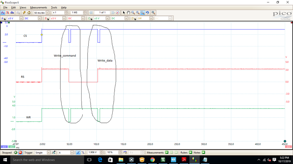

Initially All controll pin high for 50ms then Write_Command(); delay 50ms Write_data();
please see the attachement.
T J
Lead
which trace is which ?
where is the nCS pin ? RST pin ? RS pin?
you need to see all the pins...
are you sure the data pins are doing what you expect ?
You will see the issues on the scope...
I hope you have secure hook up wires and not lose connections, did you solder them in place ?
Check the power rail is correct too, did you add a capacitor on the display side of the power wires ?
a solid ground wire is necessary, a thicker wire is always a good starting point for ground.
good luck.
i checked the level of data pin, and it is according to the data. i have reset the display at the starting of main function.
TFT proto 5" is adisplay module with SSD1963 inbult controller, it has D[0-15], cs, RD, WR,RST, TE, RS pin 3.3V and GND pin for external connection with the controller.0690X00000AqWg3QAF.png

those pins look good
You have to check the other pins and the startup code.

I cant do your work for you... , but I can see this looks wrong,
line 47
HAL_GPIO_WritePin(GPIOC, GPIO_RST_Pin|GPIO_CS_Pin|GPIO_RS_Pin|GPIO_RD_Pin
|GPIO_WR_Pin, GPIO_PIN_RESET);
all those pins should be high on startup GPIO_PIN_SET !
in Main after the pins are initialised , wait 1mS , pull Rst# low, wait 1mS , then RST# High for a proper reset.
