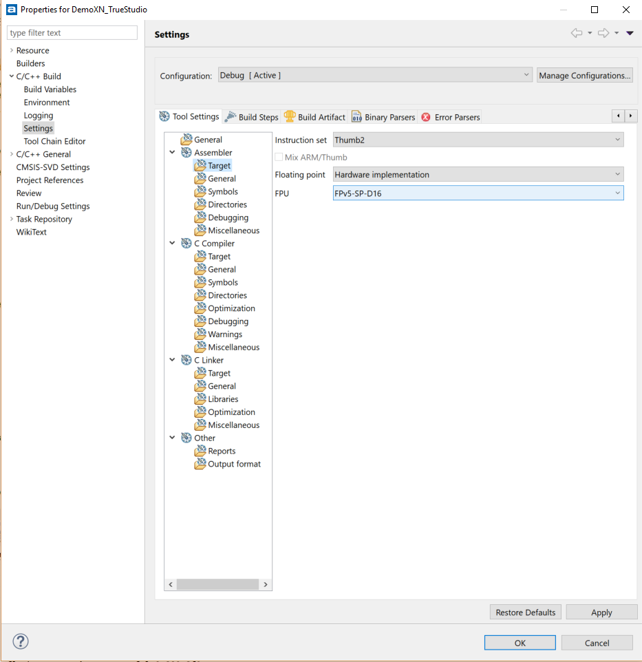

A guy
Posted on July 12, 2018 at 14:23
I had the same problem with TrueStudio (also based on Eclipse). To work around that I opened an example project for TrueStudio and I then looked at the Properties. I found out that if you want to use the software version of the library you need to set in C/C++ Build - Settings :
- Floating point '' Hardware implementation '' in Assembler
- Floating point '' Software implementation '' in C Compiler - Target and C Linker - Target.
And for the FPU settings I used '' FPv5-SP-D16 ''.
Here is a screen of the windows where you need to go to find those settings. I hope this will help other people.
