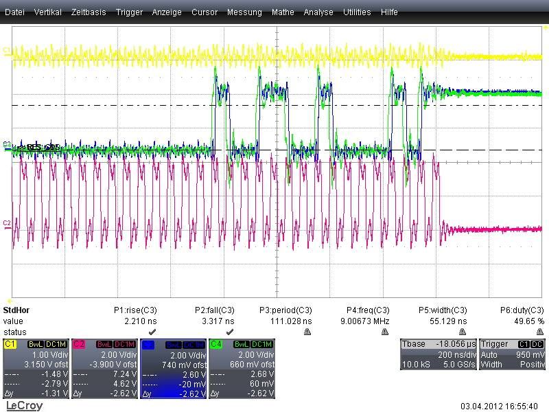

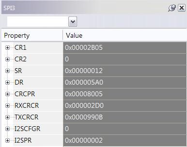

I've interesting behavior on STM32F105VC. I have SPI3(remmaped) master with SPI auto CRC calculation (RXCRC,TXCRC). For 9Mhz it is fine, for 18Mhz I receive all words correct, including
CRC, but RXCRC register is wrong and CRCERR is set. See below
                       18 MHz result
Tx frame :
spiFrameWithoutCRC (matlab endian) = '0400050000000000000000000000000000000000000000000000000000000000000000000000';
calculated crc : 990B
txcrc: 990B
Rx frame:
spiFrameWithoutCRC( matlab endian) = '0100020000000000000000000000000000000000000000000000000000000000000000000000';
calculated crc: 5A0 (binary 10110100000)
rxcrc:              2D0 (binary 1011010000)
data register: 5A0

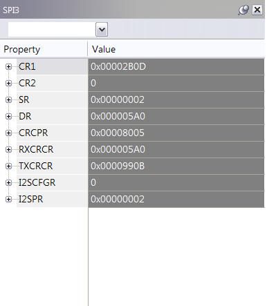

Here is just to be sure a 9MHz result

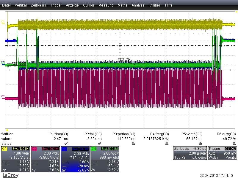

One good news: If I switch off a slave and connect MISO with MOSI on master, everything is OK.
stst9184
Posted on April 03, 2012 at 17:17
CRC (0x990B) halfwordword for MISO, MOSI from two STMs.
A whole frame is send from both slave/master. But master has wrong RXCRC.
Does somebody know what can be a reason?

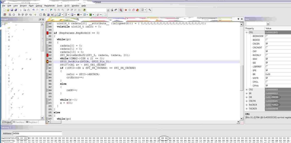

I am sending a same frame in both directions: tx16b[20] = {4,5,0,...0}, for tx last two contains a crc. I have debugger on a master. I've two breakpoints one before SPI enabled(Tx start) and one in the DMARx interrupt (TX finished). I see an interesting behavior of the RXCRC:
Step RXCRC
1      0x854D
2      0x8C87
3      0x0514
4      0x0514
I can reproduce this RXCRC error sequence. Again received data are ok:(
