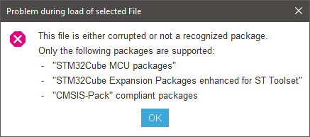

I received today the link to download version 2.6.0 of X-CUBE-SBSFU. Is it possible to install it along with the other X-CUBE Packages within the STM32CubeIDE? I successfully verified the integrity of the downloaded file and tried to install it using the "From Local..." button in the "Embedded Software Packages Manager" window.
After the decompression of the file, the following error message is produced.
How should I proceed to install this expansion package?

Hello @ntestoni
X-SBSFU is not STM32Cube package.
You just need to unzip the package and import the example project in STM32cube IDE
Best regards,
Frantz
