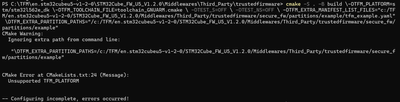

i tried adding the adc attribute to the gtzc and telling it has to be in the secure zone in the non previlaged area and tested the calling adc function but still no difference, i have not used the interrupts. From the TFM secure application im not able to debug the secure area. the debugger stops at the psa connect function and doesnt go any further, even adding breakpoint in the function and jump to the breakpoint doesnt work.
I'm trying to add a secure partition referring to the documentation of tfm, in the last step while building the tfm while adding the build configuration the cmake file doesnt recognise the platform as shown in the screenshot

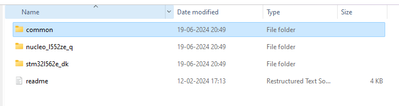

the tfm(base folder)->platform->ext->target->stm contains only 2 folders for nucleol552 and stm32l562 as shown below:
i even tried to add the platform name for the above 2 controllers. but still getting the same error. could you suggest some inputs here

Hello @PJose.4 ,
it looks like you are trying to build the STM32CubeU5 TFM delivery through Cmake. I guess it is normal it does not work because the purpose of this delivery was to provide an easy way to build the TFM through commonly used IDEs on STM32. This delivery provides an old TFM version that was not supporting STM32U5 yet in the upstream. Reason why you don't see the STM32U5 target.
So, if you want to add a new partition you should do it by creating yaml files in the TFM project.
Another way is to switch to the upstream configuration where you can get latest version of TFM (2.1 today) but you will need to build  everything through cmake and ninja.
