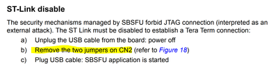

The step where the ST-Link needs to be disabled, it is not clear how can be done for NUCLEO-WBA52CG.
I found two documents, where in one document it suggests to power cycle and in the other to disconnect the CN2 pin (but its for the other Nucleo board). Please find the images attached below.
Or please can you suggest what steps needs to be taken in order to run SBSFU_Boot application on NUCLEO-WBA52CG board.
Thanks!
2023-09-20 2:05 AM
Hi @zapk ,
quoting from the readme.html file from the Cube package:
5. Reset the board
Press the board reset button, and check the log information on the terminal emulator:
* SBSFU_Boot application starts
* Then it configures the static protections (because ‘development mode’ is used by default)
* Then it get locked (because intrusion is detected)
6. Unlock the board
To exit from locked state (intrusion), remove the jumper JP2 (IDD) on the board, then put it back in place. Check the log information:
* SBSFU_Boot starts
* Then it checks the static protections, and sets the dynamic protections
* Then it verifies the SBSFU application image signatures.
* Then it jumps to the SBSFU application, displaying the User Application Main menu.
