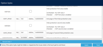

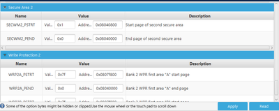

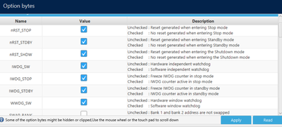

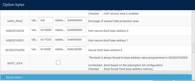

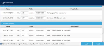

These are my Option Bytes:
Could it be something related with entering the secure side?

Hello @Claudia ,
The SECBOOTADD0 is set to 0x00C00000 which is wrong. It should be 0x0C000000.
So when you launch the debugger, debugger forces the boot address to match the one from the elf file. But as soon as a reset is triggered the MCU jumps in wrong address.
Setting the right boot address should solve your debugging issue
Best regards
Jocelyn

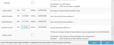

Claudia
Thank you for your reply,
Yes, you are right, I had a wrong SECBOOTADD0. Several weeks ago I tried with the following configuration and had the same problem:
However, I have a bigger problem than before. I tried disabling TrustZone and got the same as in this post:

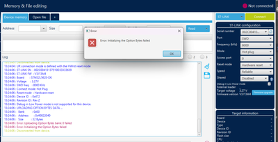

Thanks for your reply,
I tried booting from RSS by connecting BOOT0 pin to VDD as suggested in um2617 (Chapter 6.4.2). However, I got the following message "Initializing Option Bytes failed":
It seems that booting from RSS does not change things in my board.
Do you have any more suggestions? Thank you very much for your interest.
Claudia
Jocelyn RICARD
Hello @Claudia,
One possible issue is that your CPU is already stalled before performing the reset.
Please tray to have the BOOT0 connection upon power-on of the board.
1) Connect BOOT0 to VDD
2) Power-on the BOARD
3) Attach to target with JTAG/SWD in hotplug.
4) Set TZEN=0 and RDP=0xAA
Alternatively, at step 3 you should be able to attach using USB-C connector directly to bootloader
Select USB in STM32CubeProgrammer, check the USB1 port is available by pressing the double arrow button on the right
Select TZEN Regression
Press connect => This should directly launch the regression.
Best regards
Jocelyn
Claudia
I was able to connect to the board following your instructions and I was also able to debug everything perfectly. The only thing I had to do was to change the option byte SECBOOTADD0 as you advised.
Thank you very much for your help and patience.
