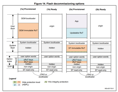

After checking internally, for HDPL levels, secure storage exists only for HDPL0 (reserved for RSS) ,HDPL1(iRoT), and HDPL2 (uRoT).
Therefore, only an HDPL+1 access is required for a user. Secure storage does not exist for HDPL3. HDPL=3 is reserved for code execution.
In RM0477, Figure 14 indicates a key store for the "iRoT" in HDPL1 and for the "uRoT" in HDPL2.
Therefore, a user will only need the NEXTKL bit to potentially access the HDPL2 secure storage from HDPL1.
For HDPL0 : Only the RSS can provision HDPL1 and HDPL2 keys using the AHK. The RSS is the immutable code that ST has embedded in the device.
but I explicitly mentioned earlier:
This question might seem irrelevant to me as I'm a user and user code will never execute within HDPL_0, but it might be important from a threat modeling point of view
so in this forum topic I'm not interested in user code (even though I am a user).
so now my question is:
How does ST's RSS code do this, what NEXTKL bit is used by ST's RSS code (HDPL0) to provision HDPL2 keys?
