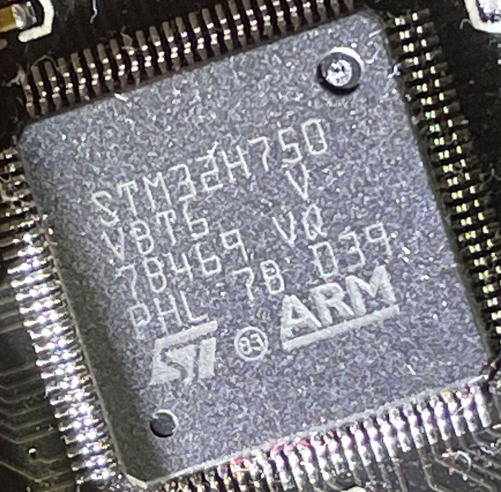

Developing AES GCM on a customer board that is used STM32H750VBT6 with CubeMX 6.1.1 has a problem needs help.
Tested example code CRYP_AES_GCM from STM32Cube_FW_H7_V1.8.0 Projects/STM32H735G-DK/Examples/CRYP is failed. And used JLINK debug figure out all registers of crypt are all zero. and test code run to DES cipher.
Has any suggestion?
Thanks

Got another 039 failure here, back/cross linking these threads so I can find them later

@Pavel A.​ Thx for this test. I retraced your steps in Mecrisp Stellaris (a Forth system) and it confirms that the HASH (and CRYP) peripherals ignore writes and read as all zeros on my STM32H750VB chip. I was going crazy because I couldn't find the bug in my code.
‎2021-08-06 3:12 PM
I have the same problem with my chip (revision V as well) with a date code of 039 (week 39 or 2020?).

More testing on V Step (ranges based on forum reporting)
2020 Week 18 working
2020 Week 36 thru 44 missing HASH/CRYP
2020 Week 49 thru 51 working
I have Y Step from 2019 08 and 2019 36, not bothering to test those
V Step part markings of boards I have whilst doing quick inventory
7B738 VQ
PHL 7B 018
7B377 VQ
PHL 7B 044
7B736 VQ
PHL 7B 049

Does seem to be an issue for parts spanning several months. Could we perhaps get an official position on the scope of the problem, and paths to remedy this? At a minimum the Weeks in 2020 when H750 parts shipped without HASH/CRYP enabled.

‎2021-08-09 1:04 PM
And what about users who already have those broken chips soldered on their (dev) boards?
‎2021-08-09 1:31 PM
Out-of-luck probably unless those parts were purchased directly from ST
VQ is "ST Crolles CR300 (France)"
‎2021-08-10 1:33 PM
Official word is that 2020 Week 22 thru 47 are impacted.
