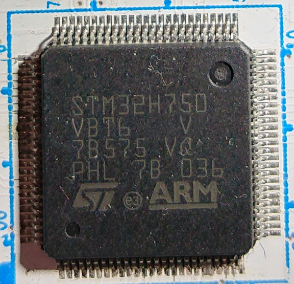

A​ttach a photograph of the IC top markings. Clear and in focus.

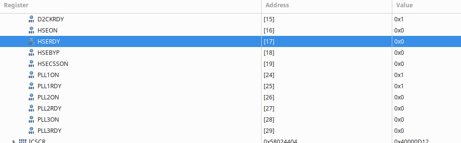

Roger, Huang
February 3, 2021
0693W000007Dm9jQAC.png0693W000007Dm9UQAS.pngTesla,
Thank your great help.
After checked HASH is also read back zero and both can not modified any bit of their registers.
I also checked RCC registers too CLK of HASH, CRPY are both enabled, but only PLL1 is enabled and stable.

Thank you for the test code. I have tried it. I confirm that it returns "false" for the chip in rev V, and that all HASH and CRYP registers return always zero. Here is a picture of this chip:
0693W000008zx1WQAQ.jpgOn an older chip in rev Y, the test code return "true" and both HASH / CRYP registers have correct values. For example, CRYP->SR is correctly initialised at 0x3. Here is a picture of this older chip that works perfectly:
Do I have to conclude that my chip in rev V does not provide the hardware HASH and CRYP functions?
Both chip are H750 versions, and according to datasheet should feature these functions.

Update: tested on CubeMX 6.2.1 , MCU package 1.9.0: Makefile generation
  1. Date code : 051 is work as register accessible.
  2. Data code: 036 is failed to access register. checked by verify program, and STM32CubeProgrammer both.
Could have any input?
