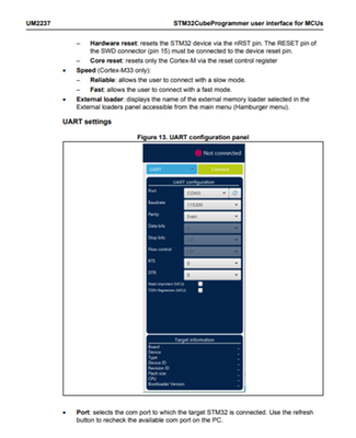

In step 6 ("Flash new User application in CLOSED state") after choosing option 1 ("Start Bootloader") in the terminal emulator, I cannot connect the board via UART/USB to the STM32CubeProgrammer.
To connect the board via UART to the STM32CubeProgrammer I had to perform a reset (RESET button). However, I cannot connect the board to the STM32CubeProgrammer via USB (User USB connector - CN3). The board with the USB cable connected performs continuous restarts.

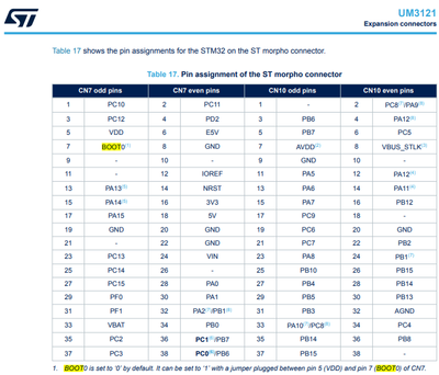

Hello @Nowy,
To resolve this issue, ensure the board is properly powered and verify the boot configuration settings (BOOT0 and BOOT1 pins). Make sure they are correctly set for USB bootloader mode.
Additionally, refer to:
I hope my answer has helped you. When your question is answered, please select this topic as solution that answered you, it will help others find that answer faster.
Thanks for your contribution.
Dor_RH
In order to give better visibility on the answered topics, please click on 'Best answer' on the reply which solved your issue or answered your question. Dor_RH
NowyAuthor
August 1, 2024
Hello @Dor_RH,
Thank You for your response. When using OEMiROT, the system bootloader is activated by software (OEMiROT) - jumping to the address of the system bootloader. The system bootloader activation method You mentioned refers to a hardware initiation (BOOT0 and BOOT1 pins).
