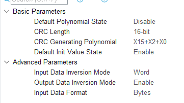

The MCU is STM32F767.
Not much to the code, but here it is: It works on the F7 if you are on 4-byte boundary (ie the first branch only). If you get down to byte access the calculation fails.
Cube MX settings:
Code (I could not figure out how to format this better). Sorry for the sloppy indentations.

Ok, so an 0x8005 polynomial, left shifting
Yes, I'd expect you'd need to change how it handles the byte-endian switching for half-words. Or perhaps writing half-words at CRC->DR + 2
The memory read via the pointer is little-endian, and the CRC is ingesting big-endian
On an MCU level the use of REV or REV16 might be simpler to manage than the peripheral
‎2024-02-22 4:38 AM
Are you suggesting I change the CRC->DR to a (u8 *) and do a +2 for u16 and +3 for u8? If you think that might work, I'll give it a shot.
