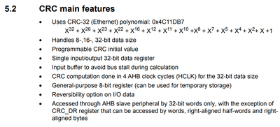

I am working with STM32F030RCTx controller. The CubeMx software is not supporting Default Polynomial State: "Disable".
I wanted to use a custom CRC polynomial and need help initiating the same. Here is a screenshot for reference:
Thanks.
1 reply
December 5, 2023
The STM32F030 does not have the capability of using a custom CRC polynomial.
Other chips in the STM32F0 family do, but not this one.
If you want a polynomial other than that, you'll need to do it in software.
