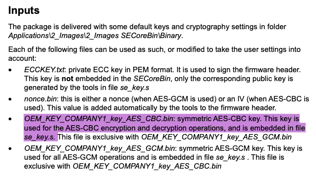

I'm trying to build the SECoreBIn, and have changed the key (OEM_COMPANY_1) in:
STM32CubeExpansion_SBSFU_V2.3.0/Projects/NUCLEO-G071RB/Applications/2_Images/2_Images_SECoreBin/Binary/OEM_KEY_COMPANY1_key_AES_CBC.bin
If I have understood correctly from the Getting strated guilde, this is the symetric AES key used to encrypt the binary in the postscript.sh later.
However, when I try to buld the SECoreBin, I am getting the following error from the python prepareimage.py script:

>ValueError: subsection not found
The string.index's raising ValueError because it can't find "-----BEGIN EC PRIVATE KEY-----".
