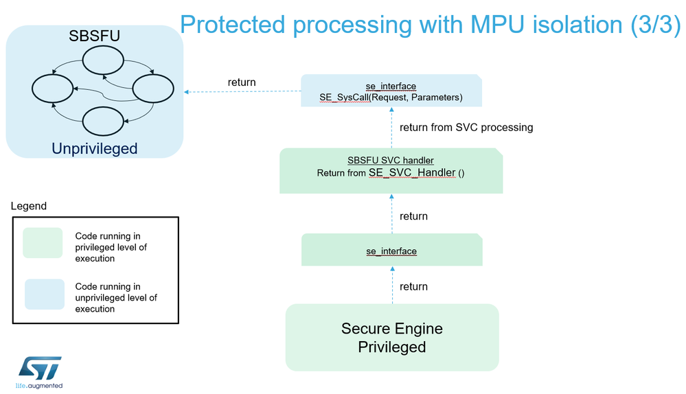

In fact you need three elements:
  • one component to configure the MPU to set up the regions so that there is an isolation
  • one "transition system" when you need to enter the isolated region running the trusted code
  • the "trusted code" running in the enclave
But please note that this separates the "standard code" from "trusted code" and forces the "standard code" to go through a unique entry point to run the trusted code.
So, this brings only isolation, not access control.
I just want to make sure this is clear for you that the main point is to make sure that only authorized users can call the revocation service, so I assume you need to install a check in the entry point.
Fred

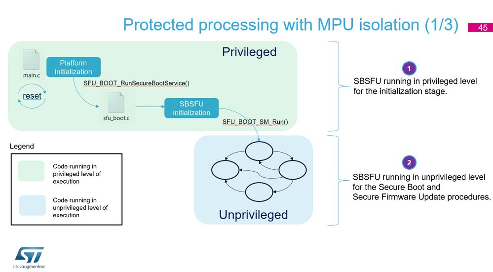

The mechanism is indeed to split the system in 2 parts:
  • one where you must be in privileged mode to run the code
  • one where you run in unprivileged mode
Secure Engine is "only" a way to put in place this isolation with a unique entry point.
You can implement this without Secure Engine, right.
Please note that this means that you need your applicative code to run in unprivileged mode by default : this can be tricky too.
The principle is this one:
