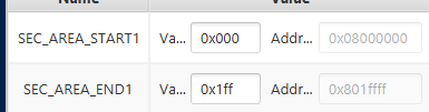

I configured the secure area using `resetAndInitializeSecureAreas`.
SECURITY bit is 1, secure bounds are valid:
But as you can see I can happily read out the memory region
Jocelyn RICARD
Hi @gpeh ,
I made a quick test:
  • I can confirm that exitSecureArea supports second parameter to control jtag reopening. After launching following code, the JTAG is open
RSS_API->exitSecureArea(userAppAddress, RSS_ENABLE_JTAG_AT_EXIT);​
  • If the user application is in second bank the call is also working fine.
  • When I set first sector of bank1 as secure memory, then launch user application on second bank, and then connect in hotplug mode with programmer, I see zeros displayed when I read first sector of first bank. All remaining flash is visible. This is expected behaviour of secure memory.
All this keeping RDP level to 0

@Jocelyn RICARD
Running again, I now see the memory zeroed out - I don't know why that was acting weird before, perhaps just something in CubeProgrammer.
And my bank1/bank2 issue was because `exitSecureArea` does not set the vector table location. My image in bank 1 set its own VTOR at startup - my image in bank 2 did not. So jumping to the bank 2 image failed.
