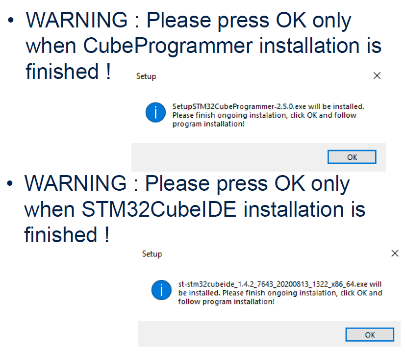

The installation instructions give dire warnings not to press OK until the installation has finished:
and, indeed, the popup appears - saying "finish the ongoing installation":
But the popup blocks the installation from proceeding - all progress stops!!
So what am I supposed to do?

In the installation instructions:

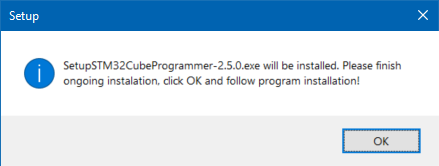

The actual installer:
0693W000005Bs3zQAC.pngthere it stops - should I press OK, or should I follow the instructions ... ?

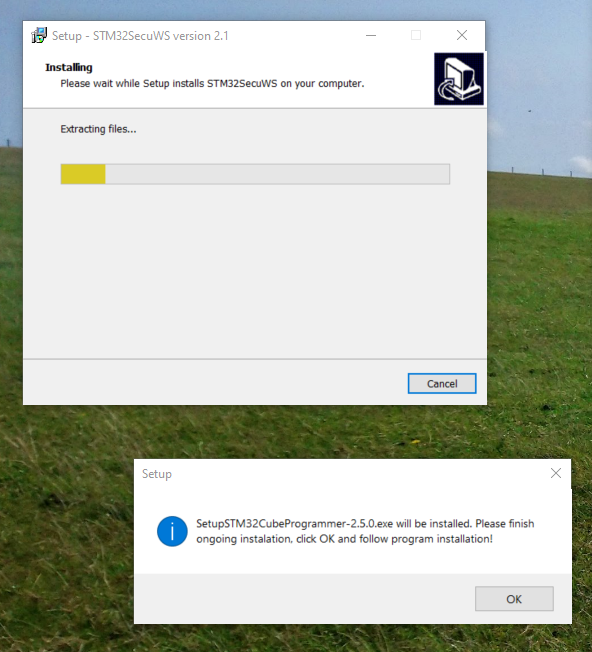

The installer is not launching the installation until I OK the message!
This is on Windows10-Pro.
I ignored what the message says, and just pressed 'OK' - and all the installations appear to have completed.

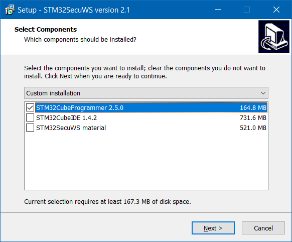

So I ran the STM32SecuWS setup again, and selected only the Cube Programmer:
Again, this message appears:
0693W000005BxIfQAK.pngBut that stalls the installation - nothing happens so long as that message is displayed.
I have to click the 'OK' to get the installation to start.
But, once I click OK, it does seem to proceed.

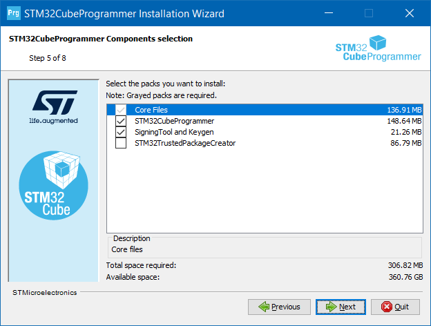

This dialogues is not mentioned in the PDF:
0693W000005BxJsQAK.pngShould the 'STM32TrustedpackageCreator' be checked?
(I did check it, just in case...)
The CheckEnv.bat does now confirm that STM32CubeProgrammer v2.5.0 and SBSFU installations are OK.
Is there anything else I can do to verify that everything is fine?
