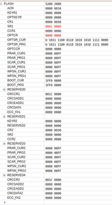

i am trying to enable the secure user memory on the stm32h743 using the x-cube-sbsfu project and have the following problem:
After activating the security bit, the value of the OPTSR_PRG flash register is not changing, so the security bit is not set and therefore i cannot configure the secure user memory.
I use the function SFU_LL_SECU_SetProtectionSecUser from the sfu_low_level_security.c file for the configuration and before calling the function i also called HAL_FLASH_Unlock() and HAL_FLASH_OB_Unlock().
Does anyone know what could be the problem?

Hello @aco990 ,
The STM32H743 does not support the secure memory, only STM32H753.
Example provided in SBSFU is for NUCLEO-H753ZI
Difference between the 2 chips is only related to security : Secure memory and crypto accelerator.
Best regards

Yes, thank you @Jocelyn RICARD  for replying! I also saw it yesterday in the datasheet that it doesn't support it
