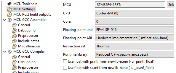

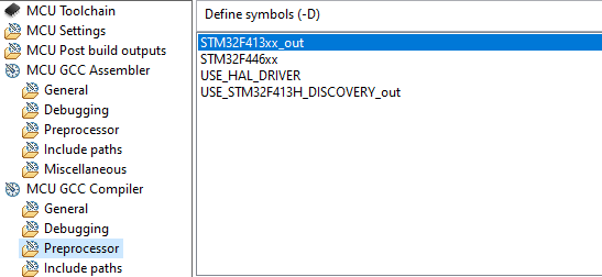

  • I changed the toolchain settings:

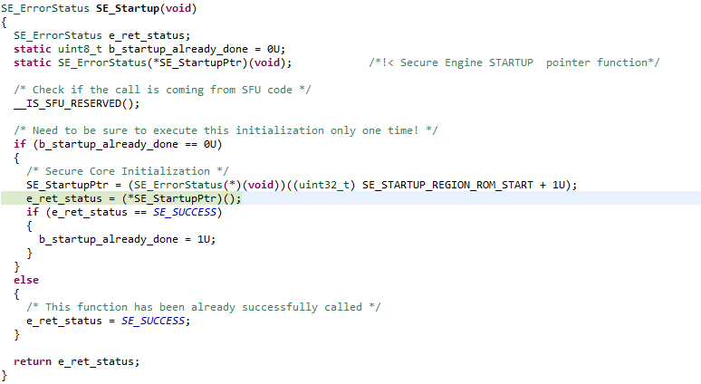

Ok, I optimized for debug and can no see where it happens:
0693W00000HpvsAQAR.pngSeems to be a problem with the ROM region
1 REPLY 1
Bubbles
Hi @STsch.1​ ,
apparently SECoreBin initialization fails. When you changed the build settings for debug, maybe the code size increased and you need to revisit the linker settings.
BR,
J
