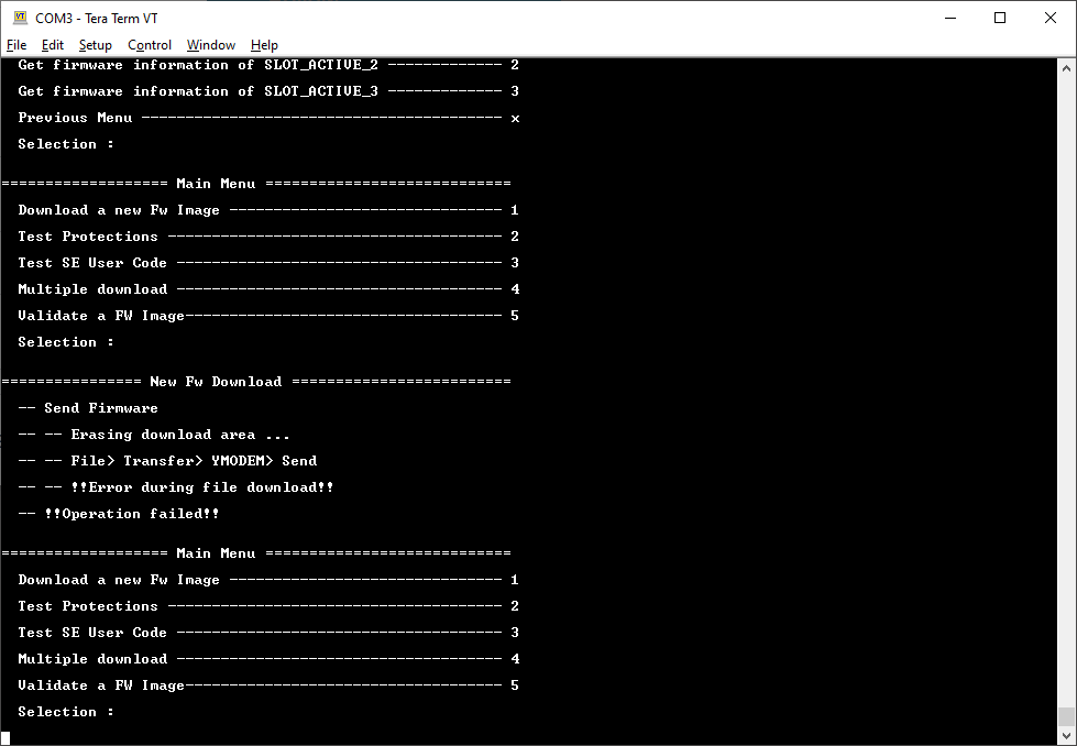

Firmware download via Y-Modem crashes with the following error when selected in UserApp example project "!!Error during file download!!".
‎2023-05-01 10:18 AM - edited ‎2023-11-20 6:44 AM
Hello guys I hope you can help me with my problem regarding my adaptation of sbsfu.
I'm currently adapting the stm32f413h-discovery example project on a stm32429zi. Everything works fine with one mayor exeption. I have difficulty downloading a new firmware version via Y-Modem. Everytime I want to downlaod a newer version (e.g. changed version nr. in postbuild.bat and in userapp.c) the download crashes and I get the following output via terminal. (all securities where off during testing)

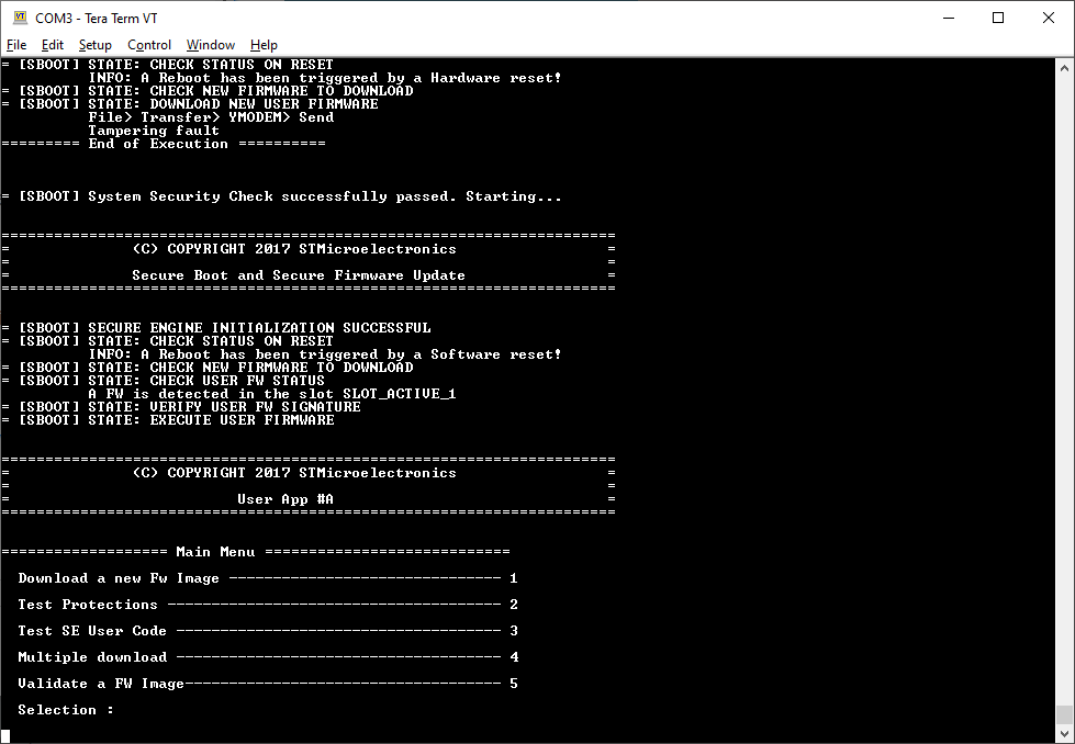

I can however download the firmware successfully when holding the userbutton on a reset like it is mentioned in um2262 chapter 8.4.
I have tested this with multiple version numbers, all have worked.
I also tried activating securities and then using the user button, but in this case a button bush is considered a "Tampering fault".
I have also figured out that both methods (download in sbsfu and download in userapp) use completly different functions. I'm not familiar enougth with how Y-Modem works to find any helpful differences between those functions that could lead to such an error.
I have listed my hardware and software I'm currently using , hopefully it helps.

‎2023-05-02 6:08 AM
Hi @Pascal Seiz​,
can you please try getting an older TeraTerm?
I personally use version 3.84. I believe later versions modified their approach to variable block length and that is not supported in the SBSFU implementation of the YMODEM.
If that doesn't help, let us know and we'll try to investigate further.
