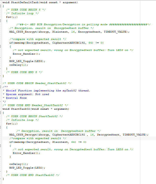

Attached a main.c file running STM32H7B3I-DK as the nucleo-h753ZI is not available for me. It is easy to migrate it to nucleo-h753ZI.
The freeRTOS project contains 2 Tasks, one for encrypt and the second for Decrypt. The default settings of FreeRTOS are used.
To reuse the project, you can generate a new one for nucleo-h753ZI by CubeMx enabling the TIM6 as source of Tick. Then use this main.c file instead of the generated one.
