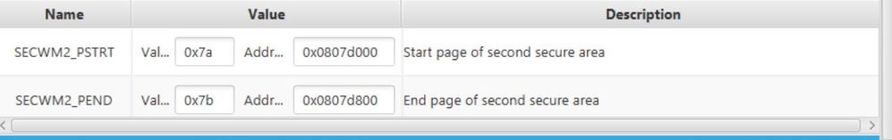

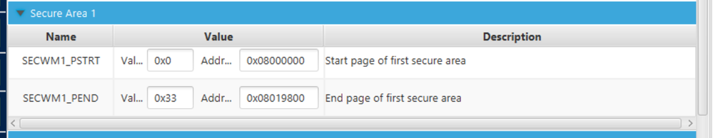

I am using TFM-SBSFU example provided in STM32L5.
Secure Area 1 which is already configured as below.
When I am trying to read 0x8012000 from non-secure application, I am getting secure fault.
I want to add one Partition 0x807d000 of 4KB into secure after the non-secure partition.
I am able to add it by modifying the option byte by following the bootloader code

When I try to read that partition from the nonsecure application, It reads 0x00 but does not create a secure fault. Is it expected behavior? is there any other configuration required besides it?

Hello @PYada.1​,
what is your DBANK setting? The SECWM2 final address range displayed in CubeProgrammer is probably only correct under certain circumstances. The actual range depends on memory mapping, it's too complex for the simple macro in the CubeProgrammer to display correctly.
Yo need to dive into the RM to get this right.
