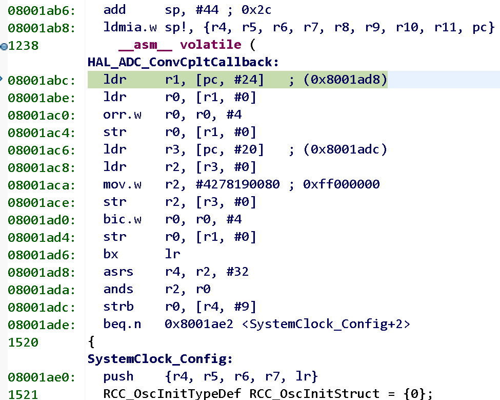

However the generated code looks like the image below...

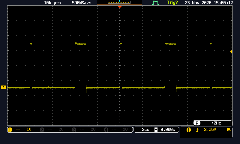

Using this generated code, the GPIO pin to the Oscilloscope produced a pulse with varying width as shown in the image below
From my assembly code above, the pulse width should be more or less identical since I am running the same number of instructions each cycle. But I do not know why I cannot get the compiler to follow the assembly code that I wrote in my C program.

EDIT1: Does anyone know why the compiled Assembly code is not the same as my inline assembly code? I would prefer this part of assembly code to not be touched /modified by compiler optimization while still using the optimize for speed option.

Which core ?
If You use CubeMx do not expect, optimal code.
Writing an assembler, is not necessary, in C will be the same, or even better.
Still using the timer will be the best idea.

A lightweight way can be achieved using register level prog. Like:
LD2_GPIO_Port->BSRR = LD2_Pin;
HAL_UART_Transmit(&huart2, &ch, 1, 0 );
LD2_GPIO_Port->BRR = LD2_Pin;
to switch a LED on before and off after the function call. It translates to efficient assembler code. For switching on:
ldr r3, [pc, #60] ; (0x8000584 <main+108>)
mov.w r2, #256 ; 0x100
str r2, [r3, #24]
even at -O0 optimization. You may use instruction level debug-stepping to check the generated code (or objdump if you dare).
ARM thumb2 cannot load general 32-bit constants in one instruction. The constants are stored at the end of the function relative to PC (first instruction).
The BSRR and BRR registers are used write-only -> no need for a read-modify-write cycles as for ODR register.
The write value (1<<8) is loaded to r2 in the second instruction. It is finally written in the 3rd instruction.
Note that r3 holds the base address of the GPIO register block and #24 is the offset of the register within that block. At higher optimization levels, the base address maybe read only once and used many times.
Don't know why your pulses vary. Maybe caching, instruction folding,... dependig on you MCU (which one?).

Then use DWT register, it is part of debug unit.

Read RM for MCU not for board or better cortex M4 manual. But this future is for core (M3, M4 M7..)
‎2020-11-23 1:29 AM
DWT is a feature of the Cortex-M4 core and your MCU has it.
Enable cycle counter first:
ITM->LAR = 0xC5ACCE55;
CoreDebug->DEMCR |= CoreDebug_DEMCR_TRCENA_Msk;
DWT->CTRL |= DWT_CTRL_CYCCNTENA_Msk;
and read it out
uint32_t tick = DWT->CYCCNT;
uint32_t tock = DWT->CYCCNT;
