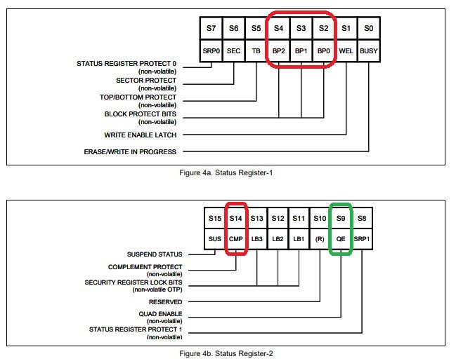

I've had a couple of people who've managed to lock out their Winbond W25Q chips, generally BPx or CMP bits get set in SR1/SR2 (non-volatile), and then erase or mass-erase fail quickly as the chip errors if it thinks that includes any protected blocks.
‎2023-05-05 3:05 PM
So is there likely something is my driver functions for Erase or Write that would've done this that I need to correct? I'm not sure what to look for.
‎2023-05-05 3:12 PM
The bits are sticky, and the people involved couldn't provide any reason why they'd get set.
I would assume that the memory got in a mode such that invalid commands were rejected (ie 4-bit commands with QE=0), or misinterpreted and then data that was supposed to go to memory went into the non-volatile status bits and got stuck there. There's not a good way to query error/status from the chips, and most code ploughs on in any case.

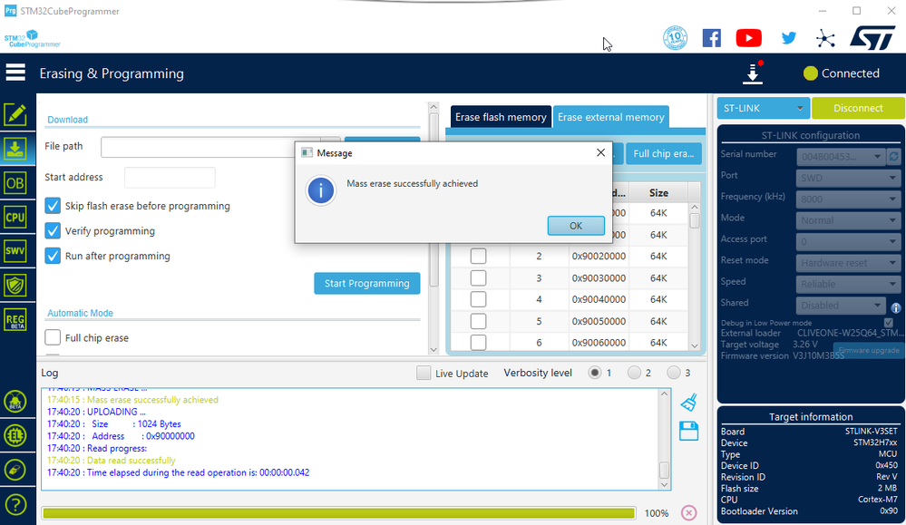

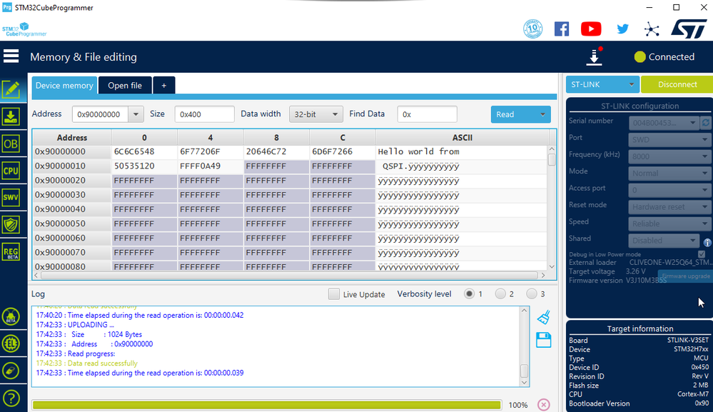

Did a Read of external flash starting at 0x90000000 for 0x1000 bytes. It read ok but didn't seem the get it back to a usable state. So then I went to try to erase the external flash chip and it seems to be hung...had to reboot to get it back. I tried to erase entire chip again and said it was successful but only took a few seconds...I went to read and the string was still there so it did not erase. Any ideas? By the way this is a W25Q64JV NORFlash.
erase entire chip:
read:

I was able to put code in to read all 3 status registers:
StatusReg1 = 0
StatusReg2 = 66
StatusReg3 = 96
So the BP register bits are not set but it appears the CMP register bit is set.
I put together another function to do the write enable and then write status register 2 with the cmp bit cleared and hallelujah the erase and write functions are operational again!!!
