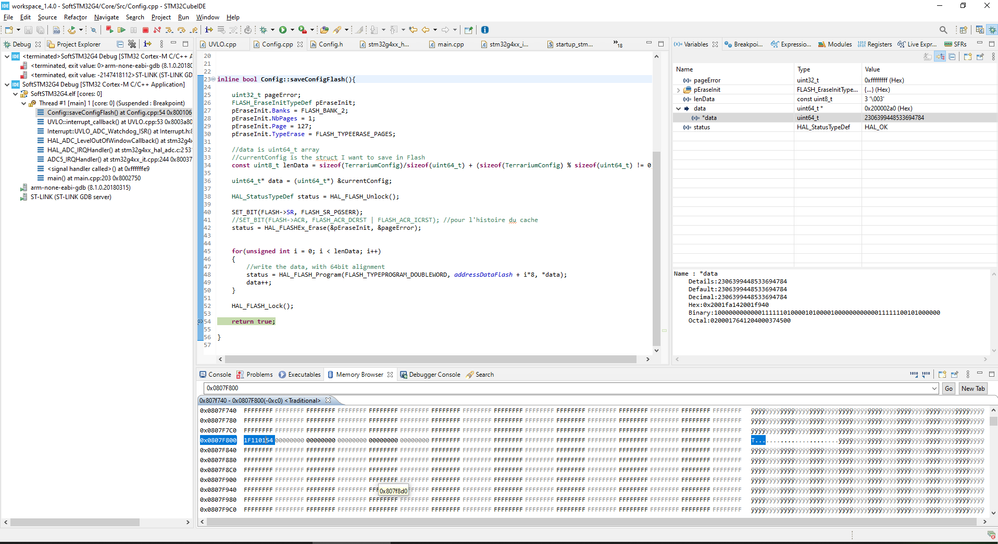

To debug, as you said, I simulate a power down to short-circuit the bottom resistor of voltage divider user to measure the voltage power supply. I put a breakpoint at the return line of the saveConfigFlash() function. Here a screenshot :
As you can see, there is something written in Flash ! :astonished_face:
In a second time, I do exactly the same without the breakpoint, but still in debug mode. In pause, I check the content, still fine, my data are here !
The third experiment, I run the code, I simulate a power down. Check the flash : once again, my data are into the flash
Now, I run the code, and try a real power down. At power on, nothing in flash, only 0x0

It is what I did, I can see the different toggles for the writing steps
