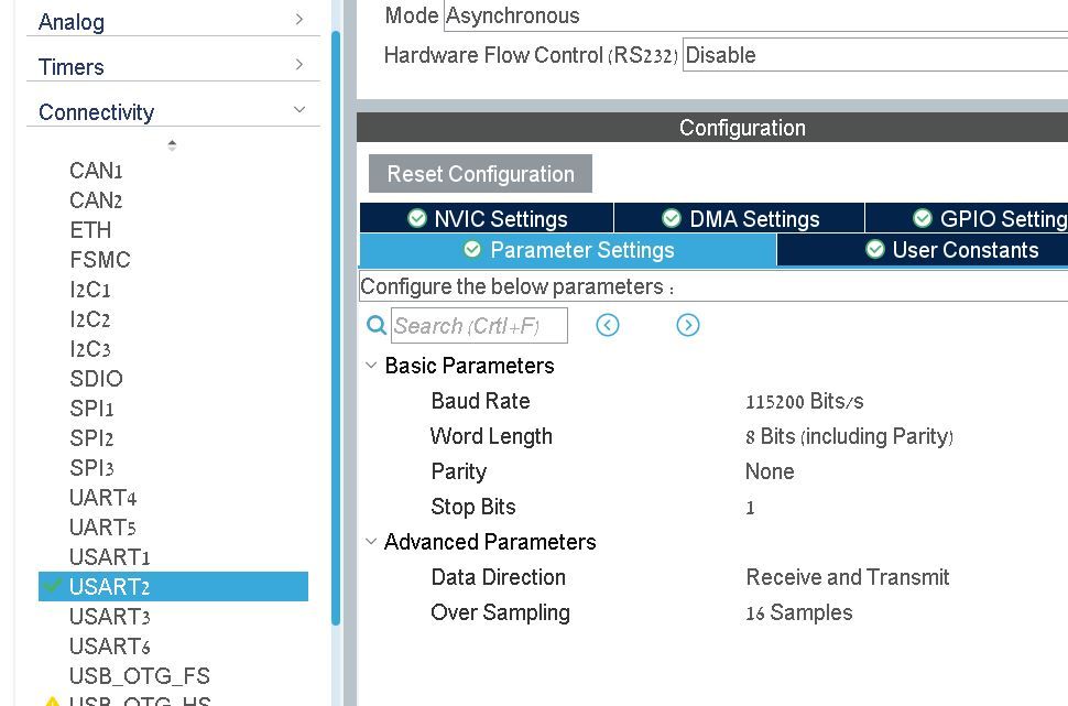

Hello,I am trying to use USART2 TX-PA2 RX-PA3 with 115200 baudrate no parity as shown in the cubeMx settings.

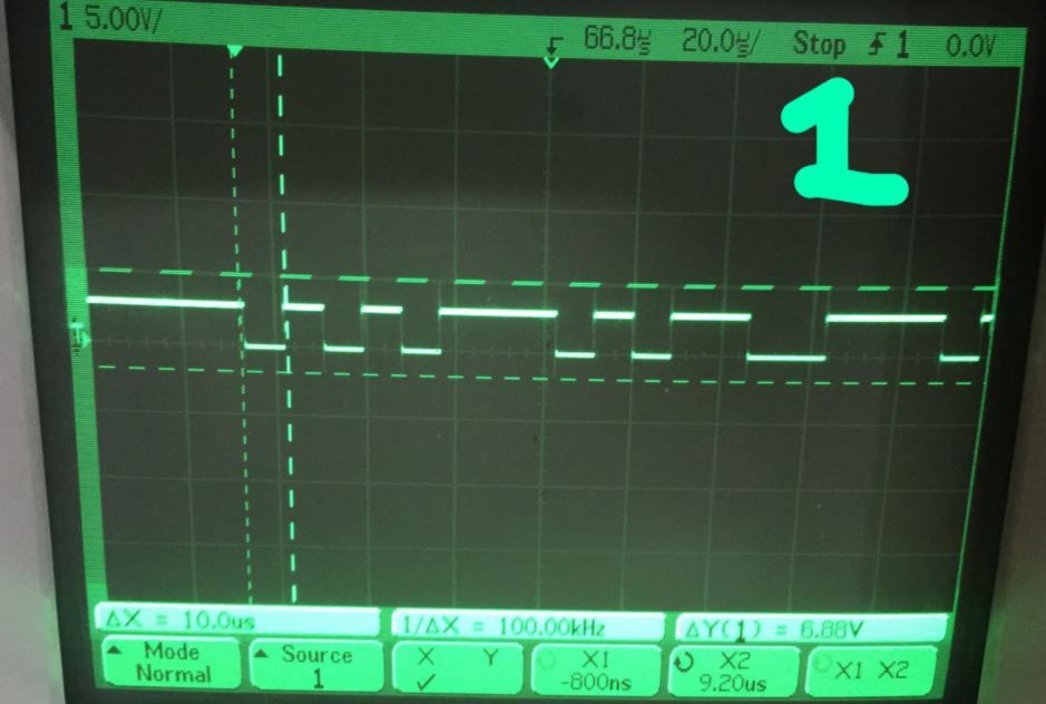

'u' in binary is 01110101
's' in binary is 01110011
I have generated the code bellow. and i got a photo of the scope signal as shown bellow.
but when i transfer the data over FTDI cable itgiving me junk although i set the baudrat and everything just like USART2.
WHat could cause such a thing?
Thanks.

2 REPLIES 2
waclawek.jan
> FTDI cable
What cable? Doesn't it require RS232 levels?
> giving me junk
What junk, exactly? Please use a terminal program which can display binary/hex values of received bytes.
Also, try to transmit from PC through that cable, and measure using oscilloscope the Tx pin of the cable, and check/post.
> FTDI cable
Yes, be more precise/specific
