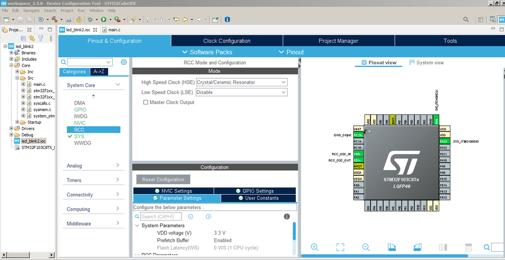

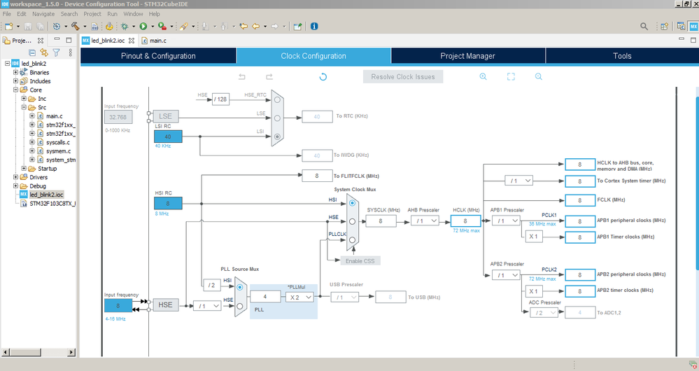

Here are my ioc file looks like;

‎2023-05-27 7:29 PM
Try to initialize this GPIOC, GPIO_PIN_13 to HIGH and LOW state individually. If this pin is initialized HIGH and LED off, with LOW and LED on, the check your code. If PC13 initialized HIGH and LED is on, the your Bluepill's user LED is not working in sink mode. It is working in source mode.
According to Bluepill schematic, the user LED at PC13 is sink mode. Your code should work fine with it.
‎2023-05-27 7:29 PM
‎2023-05-27 9:43 PM
Check the board schematic and know if the LED turns on at high or low level (active high or low).
You can go debug mode, run the code few seconds, then hold it and manually change the GPIO out register if needed play and get a feel for it.
