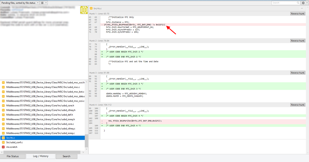

Why is RTC not preserved on purpose now?
Hello there,
In the L4 libs version 1.12.0 one can notice the following change in generated by CubeMX rtc.c file:
Why is the ability to preserve RTC after reset removed by default? This is a 180 degrees change, without informing the user. Is this intended?
