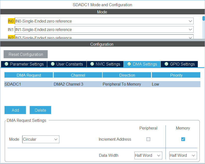

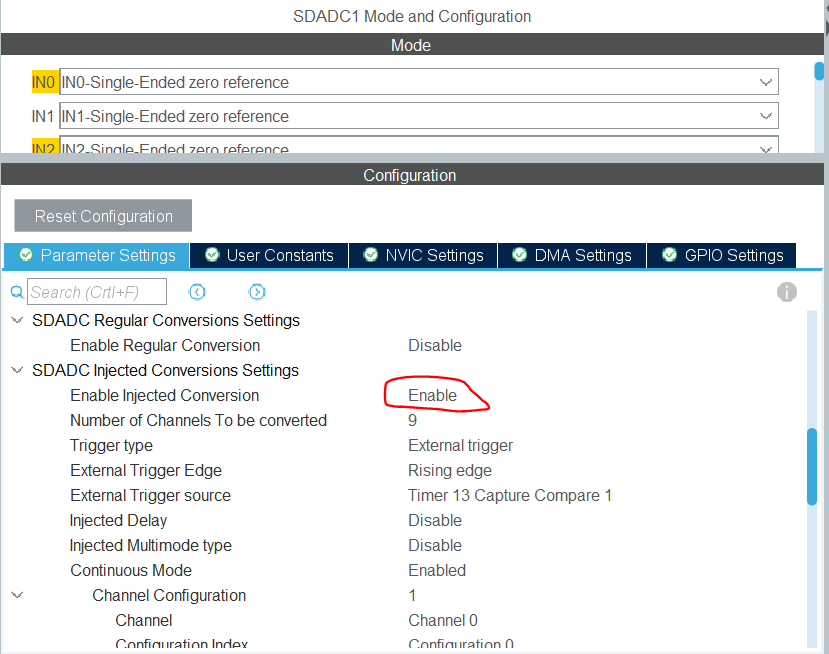

I'm doing SDADC and I think there is some issues with the DMA for SDADC in STM32CubeIDE 1.7.0.
First, I have enabled DMA for SDADC1, SDADC2, SDADC3 and I have selected InjectedConversion = ENABLE.

The first thing that happens is that STM32F373VBTx calling this function
if(HAL_SDADC_InjectedStop_DMA(handler_sdadc1) != HAL_OK)
	Error_Handler();
Then next step is that it's calling this function
/* Stop current DMA transfer */
if(HAL_DMA_Abort(hsdadc->hdma) != HAL_OK)
Then this if-statement runs
if(hdma->State != HAL_DMA_STATE_BUSY)
    /* no transfer ongoing */
    hdma->ErrorCode = HAL_DMA_ERROR_NO_XFER;
    /* Process Unlocked */
    __HAL_UNLOCK(hdma);
    return HAL_ERROR;
Because
hdma->State == HAL_DMA_STATE_READY
That means that the DMA wasn't enabled at the first time? Right?
This must be a bug, right?
And no...the SDADC with DMA does not work for me. Only with interrupt.
