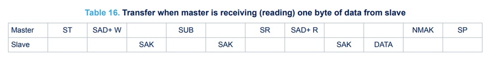

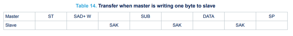

Please check the results via an oscilloscope :
  • Write :
  • Read :
0693W00000Y8uNxQAJ.pngIf nothings appears, please check the error flags set in the status register.
