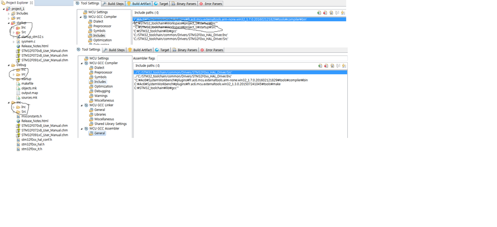

Right at the moment, the error console says,
arm-none-eabi-gcc -mthumb -mfloat-abi=soft -E ''-IC:\\Ac6\\SystemWorkbench\\plugins\\fr.ac6.mcu.externaltools.arm-none.win32_1.7.0.201602121829\\tools\\compiler\\bin'' ''-IC:\\STM32_toolchain\\lib\\gcc'' -IC:/STM32_toolchain/common/Drivers/STM32F0xx_HAL_Driver/Inc -IC:/STM32_toolchain/common/Drivers/STM32F0xx_HAL_Driver/Src -O0 -g3 -Wall -fmessage-length=0 -ffunction-sections -c -o ''startup\\Src\\stm32f0xx_ll_utils.o'' ''..\\startup\\Src\\stm32f0xx_ll_utils.c''
..\startup\Src\stm32f0xx_ll_utils.c:39:32: fatal error: stm32f0xx_ll_utils.h: No such file or directory
compilation terminated.
Kindly take a look the project properties setting, things might skip from my eyes.

Ok, read the error
The C file exists, it is trying to compile it, and tries to &sharpinclude a file it can't find on line 39
It can't find it, because a) it doesn't exist anywhere in your project tree or b) it exists but not in a path /sub-directory you are specifying correctly. For a) you'd need to physically add the file, for b) you'd need to fix the pathing, something like '../Inc' might suffice for a Src and Inc directory pairing.
I'm not going to suggest you remove the LL files, you've tried a bunch of tool chains, but still have some systemic problem with managing/creating a functioning project. I'd much rather you start studying some documentation for one chain, and create simple projects until you understand how to use the tools instead of spending weeks going in circles. Your boss needs to provide you with support, or staffing, to achieve the goals if this is a critical project.

looks like the error is saying that it can't find the file:
stm32f0xx_ll_utils.h which is referenced at line 39 in the file: \startup\Src\stm32f0xx_ll_utils.c.  Probably in an #include statement.  It seems like the directory that this file exists in is not listed in your list of places to look to resolve include requests by the compiler preprocessor.
First, take a look in the actual directory structure near the source file referenced above (the .c file) and find the .h file it is looking for.  It might be in the same directory as the .c file but it might be in a separate inc directory nearby.  wherever it is, you need to add this search path to your project.
Once you know the path you need to add, on SW4STM32:
  1.    Right click on the project folder in the Project Explorer pane at the left.  At the bottom of the drop down menu click Properties
  2. Expand down the menu item for C/C++ Build and select Settings.  In the panel of folders in the middle select Includes
  3. In the include pane at the top right, click the green + icon, and when the dialog appears type in the new path and add it.  look at the format of the existing search paths to put in a relative path (../../etc) or use an absolute path starting with C:/
If you were using CoIDE before, that IDE automatically uses any files imported into your project structure as searchable for include files.  So if that .h file was in your project under CoIDE, you wouldn't have had to do anything to explicitly tell CoIDE where it was.  However with SW4STM32, and other current Eclipse-based IDE's this is not the case.  Even if you have all of your include directories showing up in the Project Explorer, they are not include paths unless explicitly added in this way.

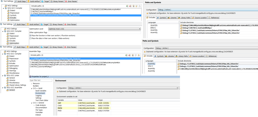

Dear Sir Aaron,
I think I did some mistake while creating my project in SW4STM32,
I just opened previous cubemx project, tried to add some files from coo-cox.
Now take a look, same source and include file are in different folder and your suggested setting.
That is wrong, isnt it?
Still the problem says,
arm-none-eabi-gcc -mthumb -mfloat-abi=soft -E ''-IC:\\Ac6\\SystemWorkbench\\plugins\\fr.ac6.mcu.externaltools.arm-none.win32_1.7.0.201602121829\\tools\\compiler\\bin'' ''-I'C:\\STM32_toolchain\\Workspace\\project_1\\startup\\Inc''' ''-I'C:\\STM32_toolchain\\Workspace\\project_1\\startup\\Src''' ''-IC:\\STM32_toolchain\\lib\\gcc'' -IC:/STM32_toolchain/common/Drivers/STM32F0xx_HAL_Driver/Inc -IC:/STM32_toolchain/common/Drivers/STM32F0xx_HAL_Driver/Src -O3 -g3 -Wall -fmessage-length=0 -ffunction-sections -c -o ''startup\\Src\\stm32f0xx_ll_utils.o'' ''..\\startup\\Src\\stm32f0xx_ll_utils.c''
I think,
stm32f0xx_ll_utils.c is still in the path.

Posted on December 07, 2016 at 05:06
Dear Sir,
I also do believe it comes from C file, we saw it before and talked a lot more.
Do you  think what mistake I am doing is, indicating same (
stm32f0xx_ll_utils.h)
file path in different folder at project tree?
Take a look the second image.
To get relief from this file, dont you suggest me to remove such low level '
_ll_'  type  files?
Regards
Hasan

Posted on December 07, 2016 at 06:45
Dear Sir Clive1,
I will for sure study the d
ocumentation for one chain.
At this moment, I find a clue (not sure its a reason)
As you said,
''../Inc'' must be follow, I saw my Korean WIN OS, might be showing 'W' symbol instead of
I have correctedthis sign.
If you cant see the image in this post, kindly find it in attachment.
Now the console says,
4:32:45 **** Incremental Build of configuration Debug for project project_1 ****
Info: Internal Builder is used for build
arm-none-eabi-gcc -mthumb -mfloat-abi=soft -E -IC:/Ac6/SystemWorkbench/plugins/fr.ac6.mcu.externaltools.arm-none.win32_1.7.0.201602121829/tools/compiler/bin -IC:/STM32_toolchain/Workspace/project_1/startup/Inc ''-IC:/STM32_toolchain/Workspace/project_1/startup/Src -I'C:/STM32_toolchain/lib/gcc' -I'C:/STM32_toolchain/common/Drivers/STM32F0xx_HAL_Driver/Inc' -I'C:/STM32_toolchain/common/Drivers/STM32F0xx_HAL_Driver/Src' -O3 -g3 -Wall -fmessage-length=0 -ffunction-sections -c -o startup\\Src\\stm32f0xx_hal_rtc.o ..\\startup\\Src\\stm32f0xx_hal_rtc.c''
arm-none-eabi-gcc: fatal error: no input files
14:32:46 Build Finished (took 76ms)
Have you see no
LL files, exists here.
What to do with ''
fatal error: no input files''
