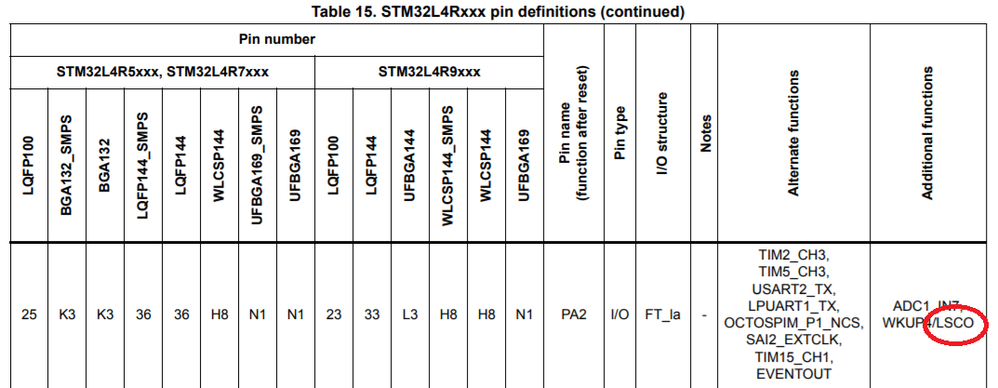

Which pin has the LSCO function on STM32L4R5xx?
I can't find it in the documentation.  I found MCO available on pin PA8, but can't find LSCO.

Hi Jeff,
It's available through pin PA2.

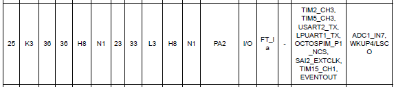

Thank you!  This is what it looks like in my copy of the data sheet.  Now I know why I couldn't find it with the acrobat reader ''find'' feature:
Posted on June 26, 2018 at 19:15
I had a somewhat frustrating time with the STM32H7 manuals, Acrobat couldn't search labels on block diagrams, etc, and doing a copy-n-paste on the text resulted in non-printable characters. This was with official Adobe readers, not random viewers.
The Technical Writers might want to dig into some of the settings/options to ensure these documents are properly searchable and indexed.
