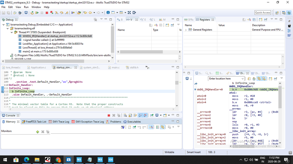

when i resume for running programme continuousaly then its going to hardfault_handler but on screen its showing wwdg_irqhandler why its happning like that i dont know even i did not understand where is the problem

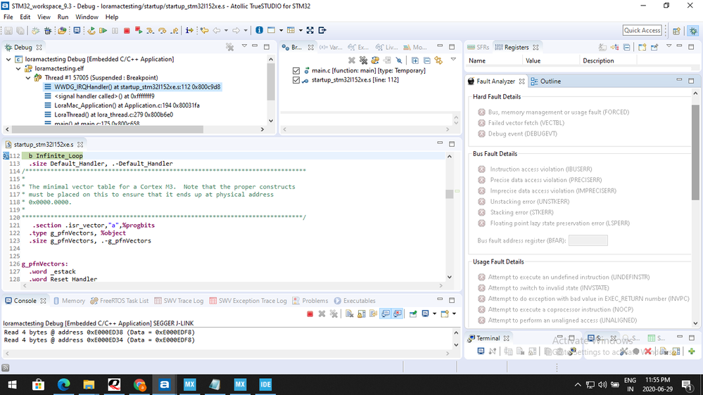

It is going to the Default_Handler which is the dumping ground for ALL the interrupts you haven't explicitly provided a IRQHandler for.
You'll like have a dozen handlers, including WWDG_IRQHandler resolving to the same address. Review startup.s
Consider which peripherals and interrupts on them that you are enabling
Asing.3
but i enabling only two interupt uart and rtc then how its going on WWDG_IRQHandler
Asing.3
thanks a lot i solve the problem from two days its annoying
