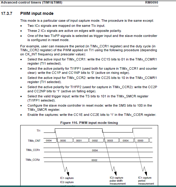

For the second case
To know the duty cycle need to know the period of a PWM signal and the pulse width.
Take a look at this approach from St
It's from RefManual of F4 series
After you start HAL_TIM_IC_Start(..) you can continously read the  captured values of CCR1(Period) and CCR2(Pulse width)
There is an example also in F4 firmware (HAL) for PWM Input.
Regards
vf

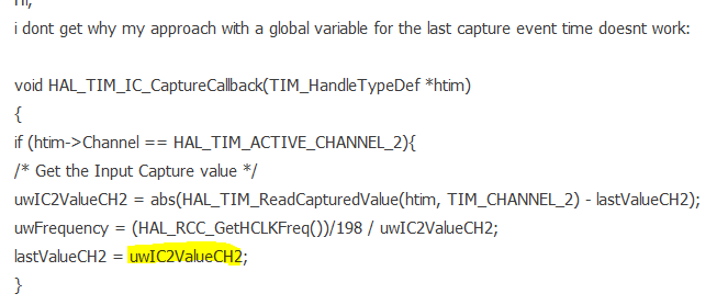

Posted on September 11, 2017 at 13:45
i dont get why my approach with a global variable for the last capture event time doesnt work:
void HAL_TIM_IC_CaptureCallback(TIM_HandleTypeDef *htim)
if (htim->Channel == HAL_TIM_ACTIVE_CHANNEL_2){
/* Get the Input Capture value */
uwIC2ValueCH2 = abs(HAL_TIM_ReadCapturedValue(htim, TIM_CHANNEL_2) - lastValueCH2);
uwFrequency = (HAL_RCC_GetHCLKFreq())/198 / uwIC2ValueCH2;
lastValueCH2 = uwIC2ValueCH2;
if (htim->Channel == HAL_TIM_ACTIVE_CHANNEL_1){
uwIC2ValueCH1 = HAL_TIM_ReadCapturedValue(htim, TIM_CHANNEL_1) - lastValueCH1;
uwFrequency = (HAL_RCC_GetHCLKFreq())/198 / uwIC2ValueCH1;
lastValueCH1 = uwIC2ValueCH1;
Please ignore the HAL_TIM_ACTIVE_CHANNEL_1 branch, its currently not executed because nothing is connected tpo the pin.

Posted on September 11, 2017 at 14:55
Hi
with a first glance, at this part of code
you assigned to lastValueCH2  the difference  and not the last captured value.
The result finaly is not correct.
