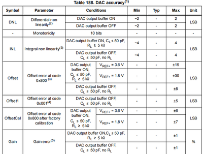

What is the test temperature range for the electrical characteristics of the DAC?
SONGTAOSI
HI,
I have been evaluating the DAC module of STM32H743IIT6 recently. However, the data provided in the data sheet does not specify the temperature conditions under which it was measured. When I conducted the high-temperature test at 125℃, the measured data exceeded the standards given in the data sheet. Could you please inform me of the temperature range within which the DAC values in the data sheet were measured? Looking forward to your reply!
AScha.3
but temp.range is for xxxT6 (you have this - right ?):
So what deviation you get at 85°   (max. ambient temp.) ?

Thank you  for your answer. The data measured at 85℃ meets the requirements of the manual. Also, there are two question that puzzles me.

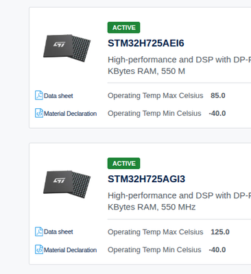

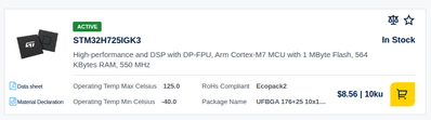

2.The STM32H743IIT3 can operate at 125℃. Why can't I find the STM32H743IIT3 product on the official website?

2. STM32H743IIT3 can operate at 125℃.  Every chip can basically work at 125° - but question is lifetime and thermal drift of parameters .
Every chip will have a short life , if overheated; so dont think, you get some "better" chip.
Maybe special selected for this or other parameter and corresponding much more expensive.
If you looking for cpu working (!) at 100° or more ambient, look for the automotive cpus, that are specified for cold/hot ambient.
And see the limited lifetime, the higher the chip temperature is for some time.
read:
https://www.st.com/resource/en/application_note/an5337-guidelines-for-estimating-stm32h7-mcus-lifetime-stmicroelectronics.pdf
on webside...see in e-store , but only view chips in the -3 class:
