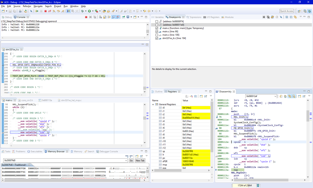

I'm back with more bizarre news! I took one of the old prototypes from work that uses L152, compiled the same kind of code and even weirder things happen. At this point I'm thinking either the FreeRTOS's port.c file supplied with STM32 firmware packages is incorrect or something is seriously wrong with these micros. I don't have enough experience with Thumb assembly to determine that.
So again I added this code to the CubeMX-generated code:__asm volatile( ''cpsid i'' );
__asm volatile( ''dsb'' );
__asm volatile( ''wfi'' );
__asm volatile( ''isb'' );
__asm volatile( ''cpsie i'' );�?�?�?�?�?�?�?�?�?�?�?�?�?�?�?�?
and I toggle a GPIO line in EXTI ISR to quickly determine whether it still works.
I put a breakpoint in the ISR which wakes the MCU up and found that the stacked PC is a nop instruction (padding) after ''main'' function. If I put a breakpoint on the instruction after WFI, press the button (which causes the breakpoint to be hit) and resume the program (with a breakpoint still present in the ISR) I can see that the stacked PC is correct.
LL_DBGMCU_EnableDBGSleepMode();�?�?�?
I just realized that I might have screwed up my previous test on the L0 because I think I somehow forgot that CubeMX enables SysTick and additional interrupts might have skewed my view. I'll try again shortly. Maybe it's the same problem.
Edit: Nope, the L053 HardFaults even without any interrupts and as I said before the stacked PC points to the ISB instruction.
Update (for the L152): I uncommented the nop instruction (visible in the attached screenshot) and now it does not get to the EXTI ISR - it just HardFaults with: SHCSR == 0, CFSR == 0x8200 (which is BFARVALID | PRECISERR), HFSR == 0x40000000 (FORCED) DFSR == 0xb BFAR == 0xb005f851 But it still works when I put a breakpoint after WFI
