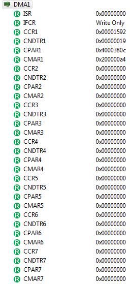

Want to trigger DMA from Timer
JustMe
Posted on October 14, 2015 at 18:22
I am using the ST32f
I would like TIM4 to trigger the DMA which should move data from memory to SPI2. Tim4 count is changing but it does not trigger the DMA. Can somebody please point out where I am going wrong - this is my first stm32 program

And does TIMx_SR.CC1IF get set? Btw., you can force the CC1 event even without having the timer actually running, by writing into TIMx_EGR register. > but it does not trigger the DMA. How do you know that? Post the relevant DMA registers as read in debugger. JW
Posted on October 14, 2015 at 22:59
There seems to be a lot of unnecessary configuration that isn't explained, perhaps instead of doing the selective cut-n-paste, you can provide a complete example that actually compiles and a description of what it should do, and at what rate, if it were to work as expected.
At the moment you seem to be creating a dependency on TIM3 that's not explained, the prescaler value isn't provided and the timer is set in a maximal count mode.

Overview: I have two external inputs. The one is the clock for TIM3 which I am using as a counter. The other input resets TIM3. Compare reg1 on TIM 3 triggers an interrupt, the interrupt enables the slave mode of TIM4 which is being clocked by the system clock. When the count reaches the TIM4 compare 1 value I want it to trigger the DMA. In the debugger I can see that TIM4 is counting up. The DMA registers all stay unchanged and the interrupt at the end of the DMA output is not triggered. Sorry about the pastes but program is made up of multiple modules, but here are most of the settings Prescaler value: PrescalerValue = (uint16_t) (SystemCoreClock / 8000000) - 1; The system clock is 72Mhz The compare values are: TIM4
X_OFFSET
== 20 TIM3 START1 == 24 TIM3 END1 == 312 DMA output in debugger 0690X000006031qQAA.jpg

waclawek.jan
Posted on October 17, 2015 at 00:22
Honestly, while I asked you to post the DMA registers content, I expected this will trigger your curiosity and you will check this yourself:
> CCR1 == 0x1592
the .EN bit is not set, thus the DMA channel is not enabled.
I don't use any ''library'', but there must be some DMA_Enable() or similar function to enable the channel.

TIM_TimeBaseStructure.TIM_ClockDivision = 0;
TIM_TimeBaseInit(TIM4, &TIM_TimeBaseStructure);
//setup the output compare
TIM_OCStructInit(&TIM_OCInitStructure);
TIM_OCInitStructure.TIM_OCMode = TIM_OCMode_Timing;
TIM_OCInitStructure.TIM_OutputState = TIM_OutputState_Disable;
TIM_OCInitStructure.TIM_OutputNState = TIM_OutputNState_Disable;
TIM_OCInitStructure.TIM_Pulse = X_OFFSET;
TIM_OC1Init(TIM4, &TIM_OCInitStructure);
TIM_OC1PreloadConfig(TIM4, TIM_OCPreload_Enable);//??
TIM_ARRPreloadConfig(TIM4, ENABLE); //??
TIM_SelectMasterSlaveMode(TIM4, TIM_MasterSlaveMode_Enable);
TIM_SelectOutputTrigger(TIM4, TIM_TRGOSource_OC1Ref);
TIM_DMACmd(TIM4,TIM_DMA_CC1, ENABLE ); // Enable TIM1_CC1 DMA Requests
//Interrupt setup
//Enable DMA1 channel IRQ Channel
NVIC_InitStructure.NVIC_IRQChannel = DMA1_Channel1_IRQn;
NVIC_InitStructure.NVIC_IRQChannelPreemptionPriority = 0;
NVIC_InitStructure.NVIC_IRQChannelSubPriority = 0;
NVIC_InitStructure.NVIC_IRQChannelCmd = ENABLE;
NVIC_Init(&NVIC_InitStructure);
//DMA1 setup
//Transfer Data to SPI2 from RAM buffer
//Trigger from TIM4 OC1
DMA_Cmd(DMA1_Channel1, DISABLE);
DMA_DeInit(DMA1_Channel1);//reset DMA1 channe1 to default values;
DMA_InitStructure.DMA_M2M = DMA_M2M_Disable;//channel will be used for memory to SPI transfer
DMA_InitStructure.DMA_Mode = DMA_Mode_Normal;//setting normal mode (non circular)
DMA_InitStructure.DMA_Priority = DMA_Priority_Medium;//medium priority
DMA_InitStructure.DMA_PeripheralDataSize = DMA_PeripheralDataSize_HalfWord;//source and destination data size half word=16bit
DMA_InitStructure.DMA_MemoryDataSize = DMA_MemoryDataSize_HalfWord;
DMA_InitStructure.DMA_MemoryInc = DMA_MemoryInc_Enable;//automatic memory increment enable.
DMA_InitStructure.DMA_PeripheralInc = DMA_PeripheralInc_Disable;
DMA_InitStructure.DMA_DIR = DMA_DIR_PeripheralDST;//Location assigned to peripheral register will be destination
DMA_InitStructure.DMA_BufferSize = COL / 2;//amount of data to be transfered - divide by 2 because we using 16bit
DMA_InitStructure.DMA_PeripheralBaseAddr = (uint32_t)&SPI2->DR;//source and destination start addresses
DMA_InitStructure.DMA_MemoryBaseAddr = (uint32_t)MemBuf;
DMA_Init(DMA1_Channel1, &DMA_InitStructure);//send values to DMA registers
DMA_ITConfig(DMA1_Channel1, DMA_IT_TC, ENABLE);// Enable DMA1 Channel Transfer Complete interrupt
//SPI setup
SPI_InitStructure.SPI_Direction = SPI_Direction_1Line_Tx;
SPI_InitStructure.SPI_Mode = SPI_Mode_Master;
SPI_InitStructure.SPI_DataSize = SPI_DataSize_16b;
SPI_InitStructure.SPI_CPOL = SPI_CPOL_High;
SPI_InitStructure.SPI_CPHA = SPI_CPHA_1Edge;
SPI_InitStructure.SPI_NSS = SPI_NSS_Soft;
SPI_InitStructure.SPI_BaudRatePrescaler = SPI_BaudRatePrescaler_8;
SPI_InitStructure.SPI_FirstBit = SPI_FirstBit_MSB;
SPI_InitStructure.SPI_CRCPolynomial = 7;
SPI_Init(SPI2, &SPI_InitStructure);
//Connect output to alternate function - AF2
GPIO_PinAFConfig(GPIOB, GPIO_PinSource15, GPIO_AF_5); //MOSI on SPI2
SPI_Cmd(SPI2, ENABLE);
TIM_Cmd(TIM4, ENABLE);
DMA_Cmd(DMA1_Channel1, ENABLE);
void DMA1_Channel1_IRQHandler(void)
if(DMA_GetITStatus(DMA1_IT_TC1))
DMA_ClearITPendingBit(DMA1_IT_TC1 | DMA1_IT_GL1);
RowCount++;
if(RowCount >= ROW)
DMA_InitStructure.DMA_MemoryBaseAddr = (uint32_t)MemBuf;//end of buufer reached - start at beginning
RowCount = 0;
else
DMA_InitStructure.DMA_MemoryBaseAddr += COL;//move to next row in buffer
else
DMA_ClearITPendingBit(DMA1_IT_GL1);
int main(void)
Init();
for (uint8_t var = 0; var < 20; ++var)
MemBuf[50][var] = var;//put some stuff in one row of the buffer
while(1)
//put your code here
