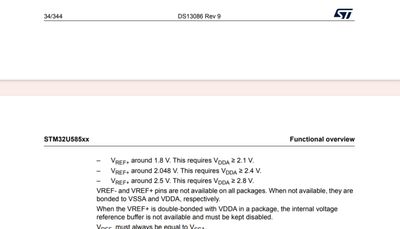

The part STM32U585RIT6 do not have a reference power + pin.
How can I connect an external reference power to this Micro?
Thanks!
1 REPLY 1
STTwo-32
Hello @YFANG.2
As you can see on the DS13086:
"VREF- and VREF+ pins are not available on all packages. When not available, they are bonded to VSSA and VDDA, respectively.
When the VREF+ is double-bonded with VDDA in a package, the internal voltage
reference buffer is not available and must be kept disabled."
