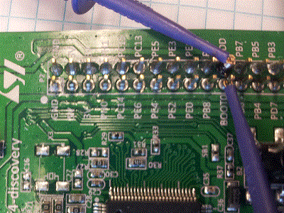

I want to make a voltmeter using my STM32F4 discovery , actually these are my first steps and I am facing some problems and I need some help.Thank you very much. #lmgtfy- Mark as New
‎2014-02-11 7:44 AM
Jumper the VDD and BOOT0 pins, restart the board, attach via ST-LINK Utilities, Connect and Erase part.
http://www.st.com/web/en/catalog/tools/PF258168
‎2014-02-11 8:33 AM
Thank you very much clive1 , it works!
the problem is solved .- Mark as New
