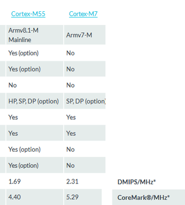

Arm giving not much differring numbers :)
M7 just 20% faster than M55 . (on Coremark)
https://documentation-service.arm.com/static/6267de1c7e121f01fd22d677?token=
https://documentation-service.arm.com/static/61bb37962183326f2176f8cc

Hi AScha.3
You are right: the M7 is faster than the M55 per MHz.
In my test, the N6 shows a speed advantage of a factor 1.22, which should place it roughly at the same level as the H7. So, the 588-MHz N6 CoreMark is 4.40 x 588 = 2'587.2 and the 480-MHz H7 CoreMark is 5.29 x 480 = 2'539. So, both machines should give very similar results on my tests.
In some tests, I even see an execution time ratio of >4.
But I’ve identified the problem — I’ll explain in a moment.
Thanks.
