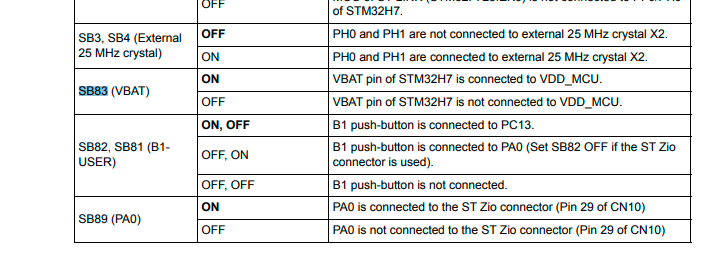

0693W00000Honj3QAB.pngYes , the default is ON (connected), then I remove it so VBAT pin disconnect from VDD-MCU

OK, you previously wrote that you removed SB86, not SB83. Incidentally, LD5 has nothing to do with SB83, since LD5 is supplied by 5V, which in turn comes via JP2, usually from 5V_USB_STLK.
However, the RTC is part of the VBAT domain. Without SB83, VBAT must of course have a sufficient voltage so that the VBAT domain can work.
