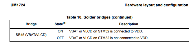

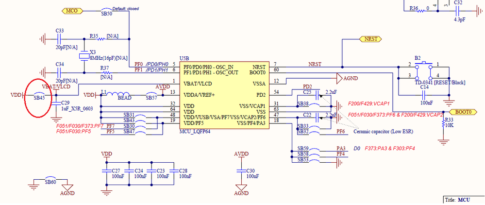

I would like to connect a battery to vBAT Pin for my Nucleo STM32L476RG.
I'm wondering if I should remove SB45 resistor or not.
If anyone could tell me what's the correct steps to build a vBAT backup circuitry.
Thank you in advance.

Yes. Remove SB45 and connect battery to pin 33 of CN7.
You might want to have a look at the L4 DISCO, it has a CR2032 battery holder too.

Yes ,you have to remove SB45 as said
