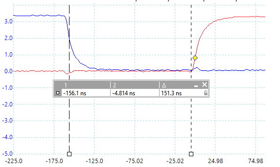

I have configure to use TIM1-CH2 Capture.
> Running on STM32F429ZI with Max 180MHz
> the code is optimised for Speed.
> the Core Freq is @ 180MHz
> the GPIO E is at Bus AHB1 ( I assume it is at 180MHz - AM I right?)0693W000000WoTWQA0.png
Here is the code
I set an output on 1 of the IO pin (configure as Very High Speed).
The result, It took approximately 152nS from Interrupt (12 Cycles) to Set the pin high.
Does this looks right? Can I shorten this even further?
