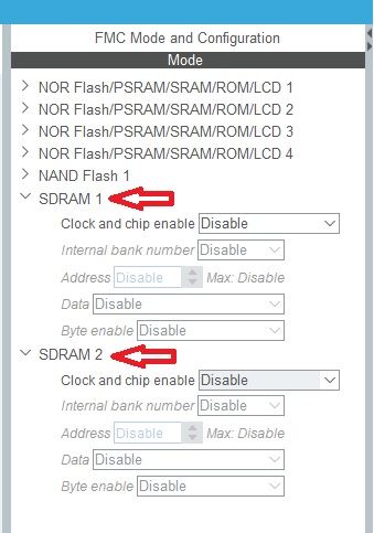

The STM32's typically have two decode "banks" providing different chip selects, this is different from the SDRAM's internal banks.

Do you mean these two?
Can you please help me how can i control and switch them? I want to work with two SDRAMs and my LCD. How i use "dma2d" for two SDRAMs?
